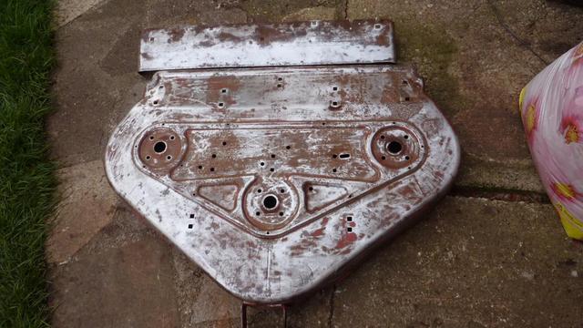

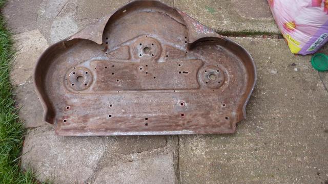

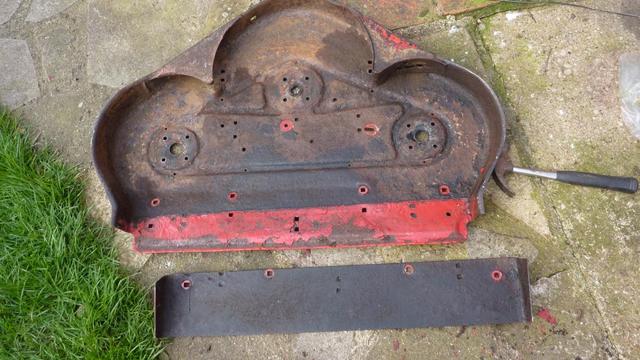

Rayp 15 #1 Posted June 15, 2014 After wet sandblasting and/or rust treatment my deck needs to be washed prior to welding/painting. Is there a product to spray on after drying the deck to prevent rerusting which can be welded and or painted over without having to first remove it? Share this post Link to post Share on other sites

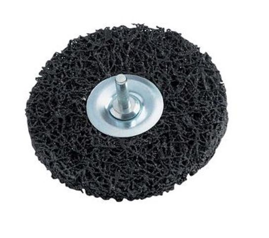

wheeledhorseman 579 #3 Posted June 15, 2014 (edited) Hi Ray (I guess) First off looks to me as though there's a little more work to do first in that I try and get rid of rather more of the brown stuff before treatment, particularly on the outside. I've found one of these to be amazing. It's an Oakey abrasive wheel from B&Q or other suppliers and it really gets the surface back to steel almost as good as dry shot blasting. The only down side is that these shred easily if you encounter a sharp edge. Even then treatment is essential - I favour products containing phosphoric acid rather than fancier ones that magically change colour but something that converts any remaining rust, which is an oxide and holds water in its crystalline structure that you cannot remove by drying into to phosphate. The underside of the deck will always to an extent be a lost cause whatever you use to treat and then paint. Unless you are just regularly trimming a neatly manicured flat lawn, only ever cutting when the grass is dry, then the speed at which the blades spin will fling grit and small stones at the paint inevitably shot blasting through both paint and the treatment underneath. I've tried all sorts of treatments and paints but basically over winter the deck has to come off for cleaning and dealing with any damage to the finish used. Cutting long wet grass, which I've had to do quite a lot earlier this season means getting all the soggy stuff off that builds up underneath after every mow - a foul PITA job that's just about manageable without taking the deck off but it does help to reduce deterioration under the deck after all the work you've put into it. Just a few thoughts - Andy Edited June 15, 2014 by wheeledhorseman 3 Share this post Link to post Share on other sites

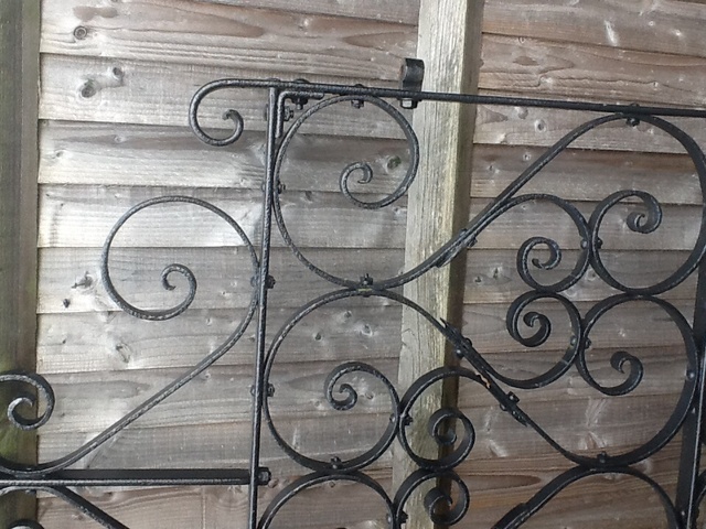

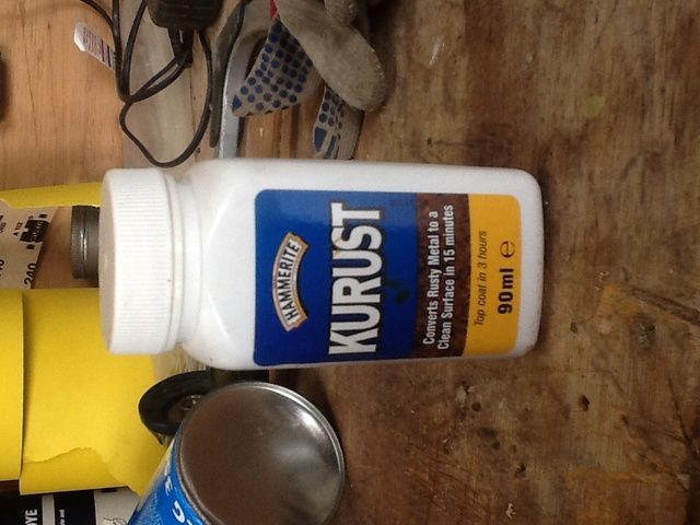

Jparkes43 329 #5 Posted June 16, 2014 (edited) I used kurust on some of my projects (including a gate) and it worked really well you just paint it on and let it do it's job and then you paint over it with the colour you want. James Edited June 16, 2014 by Jparkes43 Share this post Link to post Share on other sites
Jparkes43 329 #6 Posted June 16, 2014 (edited) Here you go I got a photo of the kurust bottle for you amd a picture of the gate (the gate isn't I'm the fence because were moving house and my mum wants to keep it. Hope you find it useful James Plus the kurust is by hamerite Sorry about them being twisted the iPad decided to do that Edited June 16, 2014 by Jparkes43 Share this post Link to post Share on other sites
