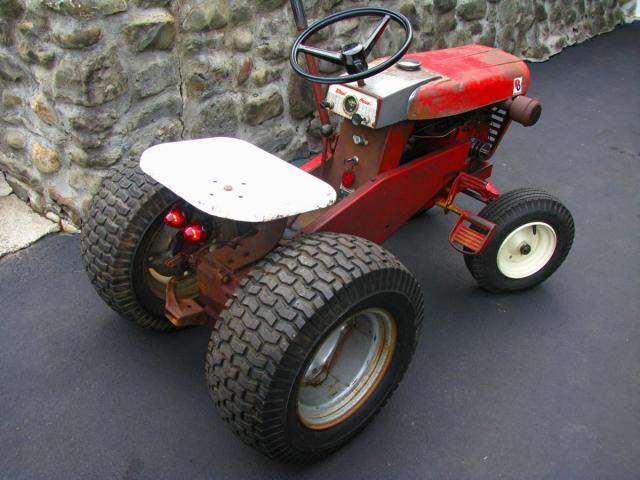

AMC RULES 37,260 #2 Posted June 13, 2014 (edited) Removed the toolbox and fenders('cuz I like this look)... to make room for these 23x9.5x12's shown here Glenn. Edited June 13, 2014 by AMC RULES 1 Share this post Link to post Share on other sites
