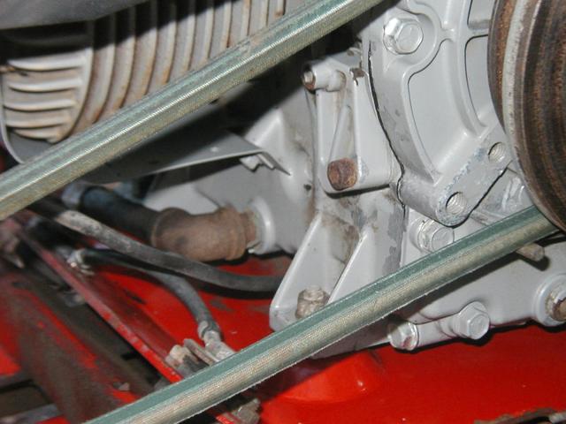

JackC 617 #28 Posted June 17, 2014 The Series II has an oil filter port cover on the engine block that is behind the PTO on a Wheel Horse application. The bottom of the cover is under the top of the drive belt in the photo below. The cover can be removed and an oil filter adapter or remote unit can be installed. There is also a port for adding an oil pressure gauge. Wheel Horse did not use the oil filter. You can jazz up the engine compartment of a Series I by adding the chrome air cleaner from a 417. 2 Share this post Link to post Share on other sites

pacer 3,177 #30 Posted June 17, 2014 Thank you JackC for that detail and pic about the oil filter being on the series ll - - I had a chance this morning to check both my engines and by golly one of them does have that cover! and it is on the tractor that has a mower deck, so I can feel much more comfortable about mowing on the few grades on my property. This forum and its members continually amaze me at the info that come forth here. Share this post Link to post Share on other sites
