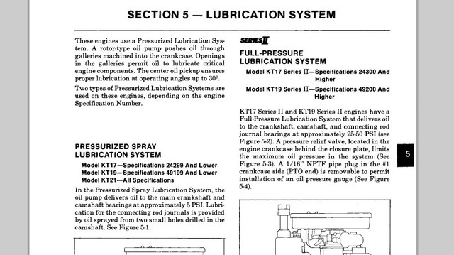

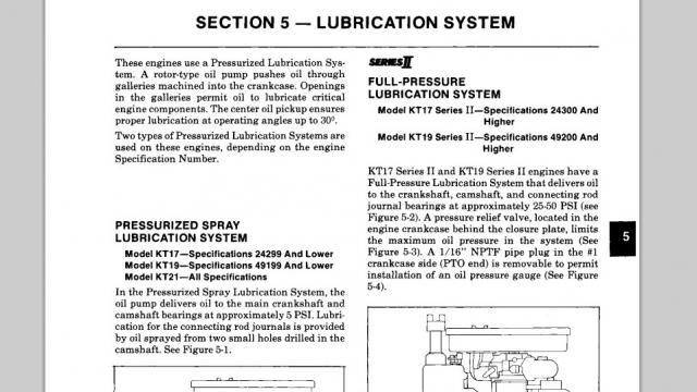

Desko 687 #8 Posted June 13, 2014 Is that a series 1 or 2 Kohler? Series 1 are no good splash lubrication no filter as a 2 is full pressure lubrication and has a filter. Share this post Link to post Share on other sites
Theroundhousernr 590 #9 Posted June 13, 2014 (edited) I don't believe there is anything bad about splash lubrication. All of our one lung kohlers are splash and we all know how they perform. And second, the KT series 1 is not splash lubrication in any way. It has an oil pump but only feeds the main bearings and cam. The cam is suppose to drip lubricate the rods. The motors are good up to 2000 hrs as long as oil is kept up with and not operated on steep hills for an prolong periods of time. Series 2 has a filter and drilled crank for feeding the rods with oil. Besides for the price, this one was coming home with me regaurdless. I would like to have a series 2 but I believe I can keep this one running a long time if it is ok from the start. kyle Edited June 13, 2014 by Theroundhousernr 6 Share this post Link to post Share on other sites
pacer 3,181 #10 Posted June 13, 2014 That tractor looks to be very clean, must have been kept inside - and sounds like you got a good deal on it too. On the subject of the KT-17's series 1 and their oiling method, I seem to recall reading somewhere Kohlers recommendation of the maximum grade to operate the engine at, anybody know what that was? I have 2 of the series one and both are in very good condition and I like them and the sound of them - I'd like to keep them that way! 1 Share this post Link to post Share on other sites
AMC RULES 37,260 #11 Posted June 13, 2014 Found here on Page 5 Pacer. Share this post Link to post Share on other sites

pacer 3,181 #13 Posted June 13, 2014 (edited) Wow! - 30° Thats a pretty steep angle! While I have a couple ditches and smallish grades I dont think I have a situation that steep. Good stuff to know. Thanks Craig... Roundhouse, I bought 2 C-175's that had been sitting outside for YEARS, one useable with an Eaton 700, and the other an 8 spd with no tranny, but good engine. I've got the Eaton up and cutting grass, and am presently adapting the other KT-17 to a C-165 that had a blown engine. They are my first KT's and as I said I've really taken a shine to them. Also my first black hoods and I've take to their style also. Edited June 13, 2014 by pacer 1 Share this post Link to post Share on other sites
