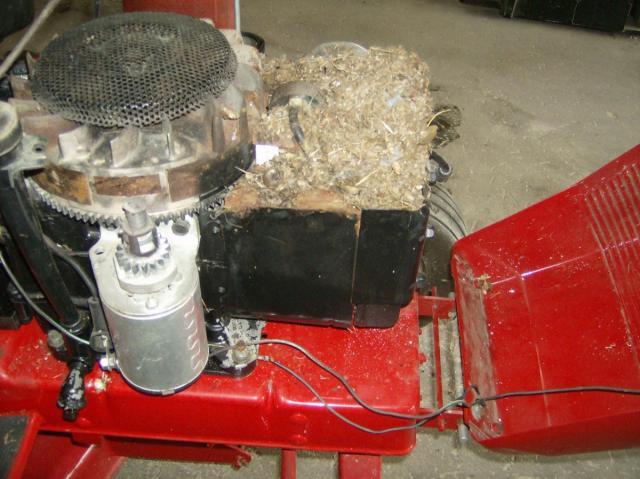

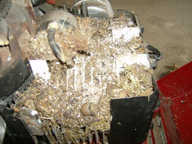

ol550 879 #1 Posted June 12, 2014 Got a chance today to check this out. Been sitting for 6 years in a shed. The fuel tank grommet had disolved and the shutoff had fallen out of the tank so I knew a carburetor cleaning was the first order of business. Then no spark. First under the shroud. Guess the little critter didn't like a power line in the middle of his house. A little digging the wire out of the coil and epoxied the new wire in and the critter will have something to chew on next winter. Share this post Link to post Share on other sites
oldredrider 2,554 #2 Posted June 12, 2014 That's a cozy looking mess! Share this post Link to post Share on other sites
