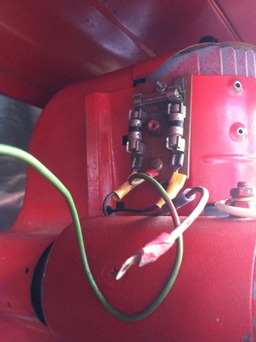

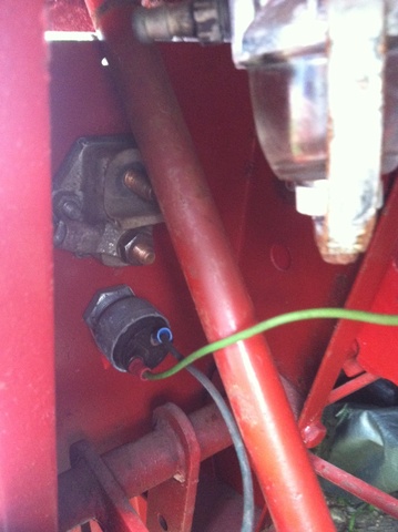

tomtractor 71 #1 Posted June 11, 2014 I have a new to me WH 653 with an original Tecumseh motor. Please let me know where the wires go on the attached photos. Specifically the wire that is in the foreground, the wire with the round eyelet. Share this post Link to post Share on other sites

tomtractor 71 #3 Posted June 12, 2014 I don't think i am getting it... I still don't know where the wire with the round eyelet goes. It is a single wire that comes out from behind the fly wheel. Share this post Link to post Share on other sites
oldredrider 2,553 #4 Posted June 12, 2014 I think that is a grounding wire for the points...the kill wire. Hooks to the back side of the regulator on "mag" terminal where you have a red lug. Share this post Link to post Share on other sites
tomtractor 71 #5 Posted June 12, 2014 OK. I will try that. Thanks. Share this post Link to post Share on other sites
oldredrider 2,553 #6 Posted June 13, 2014 (edited) Let us know what you find out...I'm going on a weak memory. Edited June 13, 2014 by oldredrider Share this post Link to post Share on other sites
