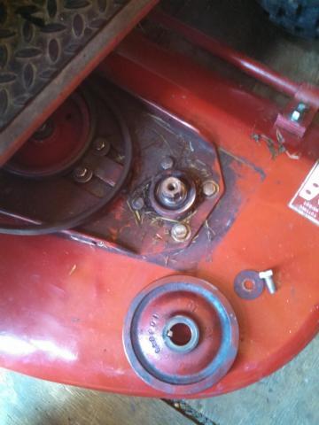

608KEB 854 #1 Posted June 11, 2014 (edited) I have a 48" SD deck. The keyways on the pulleys and shaft are worn.There is extra play in them. Can I move up a key size and get pulley and shaft machined? Also the spindles have a lot of up and down movement in them. Is this normal? They have replaceable bearings with grease zerts.I think the deck is about a 75 model. There is no ID tag on it. Pic Edited June 12, 2014 by 608KEB Share this post Link to post Share on other sites
gwest_ca-(File Mod) 12,511 #2 Posted June 11, 2014 Take a look at this file Open the 48" page and then click on the O and the Q. Each will take you to a single page that has the original spindle assembly and it's replacements over the years. These are the only 2 I see with a key and bolt to retain the pulley but did not look at them all. Garry I just changed the O and Q Share this post Link to post Share on other sites
