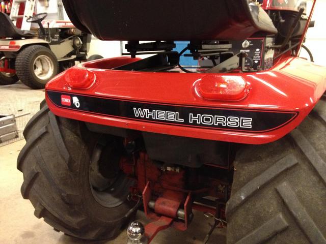

Martin 2,135 #8 Posted June 9, 2014 I would have never known that thanks for the heads up. What is the difference in the seat pans of the workhorse and the 3,4,5 series? 3,4,5 series has an extra body line below the rear full width seat pan decal. the workhorse tractor pans don't have this body line. the decals on the 3,4,5 series are narrower because of this lip, the workhorse decals go almost to the bottom of the seat pan edge. Share this post Link to post Share on other sites

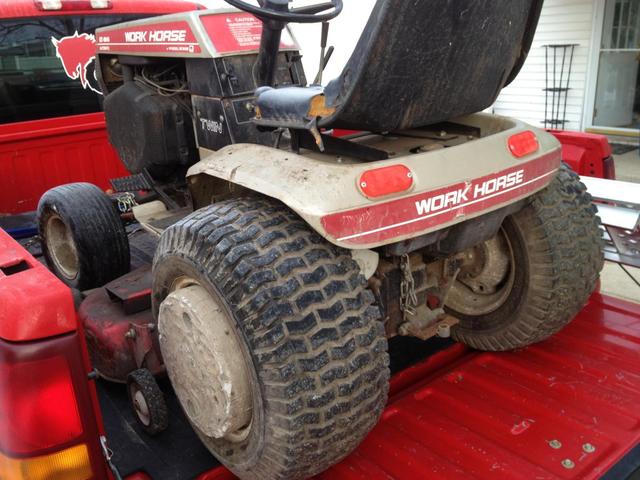

Martin 2,135 #9 Posted June 9, 2014 workhorse.... 3,4,5 series 1 Share this post Link to post Share on other sites
