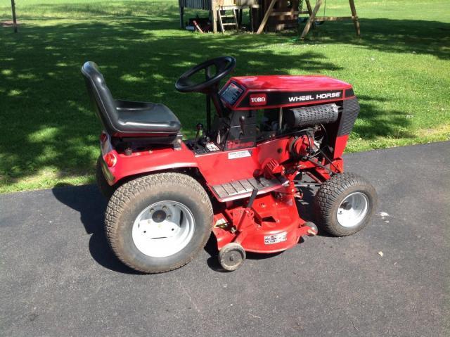

papaglide 542 #1 Posted June 8, 2014 (edited) It's a 1998 314-8 with 957 hrs. One owner, bought on 10/14/98 for $4171.93. She is beautiful! It came with all the receipts and original paperwork, including the paperwork for the 42" RD bought on 7/28/12 for $1402.92! I really lucked out with this one. It showed up at my local dealer about 20 minutes before I got there. I am really surprised at how quiet the Command is. Are the Commands as good (or almost) as the old cast kohlers? Any things that I should be on the lookout regarding the engine? The tractor runs very well, no smoke from the motor, and looks real nice. Oil change, tranny change, and tune up is on tap for tomorrow. Something that I need to address is the steering is skipping teeth when I crank her hard to the left. Other than tightening the nut with the cotter pin thru it, is there another way to remedy this? Almost forgot to ask: is there an easy way to access the eye bolt on the middle rock shaft? When I lift the deck there is about a half inch between the rubbers on the deck and the frame. Also the front wheel on the deck barely lift of the ground. I am thinking that the eye bolt needs to be adjusted. Edited June 8, 2014 by papaglide 6 Share this post Link to post Share on other sites
jmdavidh09 33 #2 Posted June 8, 2014 You can also add additional spacer washers behind the big nut to remedy the steering issue.... Nice tractor...hope the 416 is treating you well! As far as the command....make sure you blow out the cooling fins and intake housing..these seem to gunk up as much as my onans have. My 314-8 gets cleaned out atleast once a year. I have and have had a couple commands with no compliants. Just be sure to change oil/filter and clean the intake housing. Really nice tractor....score for you! 1 Share this post Link to post Share on other sites

cheesegrader 436 #5 Posted June 8, 2014 (edited) Thst's a nice find! Easiest access to the rockshaft and lift linkage is by removing the black panels between your legs. I would get rid of the machine screws holding the panels on, and replace them with stainless button head bolts. They dont rust, look great, and won't strip. P.S. I sure miss Dave Bolland. Gotta love a guy whose nickname is "The Rat"! Edited June 8, 2014 by cheesegrader 1 Share this post Link to post Share on other sites

squonk 46,177 #10 Posted June 8, 2014 You may need to replace that eye bolt. I picked up a 310-8 a couple of weeks ago and the deck didn't lift worth a hill of beans. Eye bolt was all mangled. Took off the tunnel trim to get to it. Now I remember why I like the 70's era tractors better! 1 Share this post Link to post Share on other sites
Racinbob 12,903 #11 Posted June 8, 2014 Nice tractor. It sure looks well cared for. You might want to check the transport stops too. I had to play with those as well as the eyebolt adjustment to get mine to lift properly. On one of my 48" decks up north I replaced the transport spacers with a larger diameter to get it the way I wanted it. Maybe not the proper technique but it worked great for me. As far as the Command goes, I'm happy with my 15. I think the K's and Magnums will probably last longer but the Command is smooth and quiet. 1 Share this post Link to post Share on other sites

can whlvr 994 #23 Posted June 9, 2014 nice tractor,in regaurds to the steering skipping it could also be the lock collar on the steering shaft under the dash panel,behind the battery,thats if toro didn't change the design since 1990,thats the newest horse ive wrenched on,but if the steering wheel lifts up out of the column a bit it will allow the gears to slip 1 Share this post Link to post Share on other sites
papaglide 542 #24 Posted June 9, 2014 (edited) The steering issue is fixed. PO had NO washers in place. I put 2 in behind the big nut and now she turns awesome. Racinbob, you are absolutely correct about the location of the strut, right side. The spring goes on the left. Eyebolt has been adjusted and screws replaced with some nice ss ones. Deck goes back on tomorrow and I will see how the deck lifts then. I noticed a different shape to the engine mount. The base is mounted to the frame and then curves up to perpendicular to the frame. The engine is then mounted to this. Is this designed to control vibration? Edited June 9, 2014 by papaglide Share this post Link to post Share on other sites
