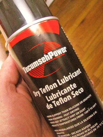

AMC RULES 37,259 #12 Posted August 2, 2014 Happened upon this today... seems like it was made for the job. Share this post Link to post Share on other sites
