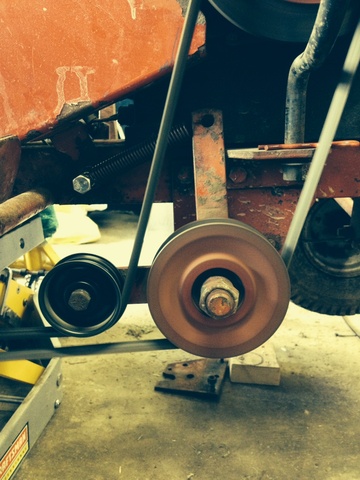

oe espo 32 #1 Posted June 5, 2014 I have been trying to get the garden in this year. first time. Having problems with most every conceivable thing it seems. Right now I keep throwing the tiller belt off. Looks like it walks too much on the mid mount idler. The black colored idler is new. Maybe latches for the mid mount are worn out? Mid mount bent where the idler bolts on. I'm thinking of a way to check how parrallel the pulleys are. Bearings on cast pulley in photo are OK, not new but seem ok since the belt goes from this pulley to PTO then to the black idler. Bearing on the PTO are also OK (acceptable i think) Any ideas appreciated. im ready to scrap the garden and food plot for this spring. MidMountIdlerWalkingBelt2.wmv Share this post Link to post Share on other sites

CasualObserver 3,416 #3 Posted June 5, 2014 I'm guessing you don't have the belt and idler pulleys perfectly inline with the PTO sheave? Can't tell from your video, but clearly it's not running true. You may be better off switching to one of the other style of idlers which would eliminate the restriction you're running into on the PTO bail. Perhaps someone with one of the newer style has one that they would trade you. Or you can likely pick one up at the show in two weeks. You can see the difference in this topic. Share this post Link to post Share on other sites
doc724 927 #4 Posted June 5, 2014 I watched the video, the belt is walking perhaps because the rear pulley and idler are either not aligned or one of the bearings (likely the idler) are not running true. I suppose the bearing sin the PTO could be bad as well, but my money is on the idler in the back 1 Share this post Link to post Share on other sites
oe espo 32 #5 Posted June 5, 2014 You know what, I think it is on the idler on the back!! Eyballing it between it and the larger diameter tiller input sheave its way off. My mind had been convinced its somewhere up front PTO etc. Becuase its starts it wobble at the new mid idler after the PTO sheave (in the direciton of belt travel), however it makes sense now. I'll keep tweeking it. Problem is that I cant find the replacement bearing insert (ecept at toro about $50 for a 1" diameter bearing) and its problably the worst play of all of them. I think its part number #4567. if anyone has a cross, let me konw. Now i have hope. Thanks! i was ready to sell all my WH STUFF I have been collecting (im a newbie)! Share this post Link to post Share on other sites
gwest_ca-(File Mod) 12,463 #6 Posted June 5, 2014 I've seen the following for #4567 Nice 7842-4 6300-2RS which is 10mm x 35mm x 11mm (.394" x 1.378" x .433") .375"x1.375"x.440" I don't know what is correct. If you figure it out let us know. Garry Share this post Link to post Share on other sites
daveoman1966 3,884 #7 Posted June 6, 2014 My bet..... You don't have enough tension on the belt. Change to a heavier spring or shorten the one that is on the now. With more tension, I don't think the belt will travel like it does. Share this post Link to post Share on other sites

brandonozz 168 #9 Posted June 6, 2014 Have you tried a new belt? My belt was jumping all over the place (and even off) and runs very true now with a new belt. Share this post Link to post Share on other sites
oe espo 32 #10 Posted June 6, 2014 (edited) I actually have a new WH belt. Didn't try it yet, guess I didn't want to damage the new one because I couldn't till more than a foot before it would jump off. I tweaked (made two tiller idlers more parallel) and actually did some tilling. But like Daveomann said the belt actually rolled over in PTO. I'm going to take tiller off so it's easier to see and work on. Align two sheaves and try new belt also look into a new bearing for tiller idler Sent from my Nexus 7 using Tapatalk Edited June 6, 2014 by oe espo Share this post Link to post Share on other sites
312Hydro 474 #11 Posted June 6, 2014 I agree with the others. More tension and a new idler. Not in that order though. I'd get that idler fixed first unless your large pulley is wobbling. My tiller jumps when breaking new ground ( thinking about adding a weight box to it) and will throw off the belt once in awhile. Someone on the forum had a very nice setup with an angle iron frame that held concrete blocks for weight.I use a plow first now and then till. It's easier on the tiller for me. Share this post Link to post Share on other sites
jachady 130 #12 Posted June 6, 2014 Usually an issue with the belt is with the tiller idler pulley. It's the one that sends the belt the longest distance back to the front of the tractor and if it's slightly off it will throw the belt a lot. It sounds like the bearing might be your issue but if that doesn't solve it, you can add or subtract washers to shim the pulley in or out. Or even bend the brace the pulley is on to get the belt traveling in the right direction. I would attempt to get the old belt to run true first, the new belt with it's stickiness will hide the problem. For guys that throw the belt while the tiller is jumping, check how tight your rear attach point is. If it's worn the tiller will actually tilt side to side and throw the belt. I've had mine built back up and I bolt the tiller into place, I don't just use pins. I also don't use a spring to hold belt tension. The mid-idler arm actually rests against the PTO bracket and holds the belt just tight enough. To me when I ran the spring the belt jumped more, it seemed to need a little more play than the spring would allow. Share this post Link to post Share on other sites
Forest Road 595 #13 Posted June 7, 2014 Speaking from experience I agree 100% with jay. If the tiller idler is off just a hair it'll pop belts all day long. I recall using washers on one tiller to shim it out. On another I just gave it a slight bend. If the bearings spin freely they're typically fine. Easiest way to check is to stand behind tractor with pto engaged and watch the belt track over the pulleys. A slight bend can make a world of difference. 1 Share this post Link to post Share on other sites
