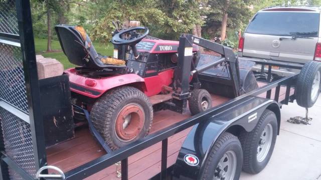

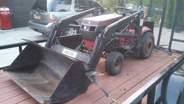

Cutlas3391 776 #1 Posted May 30, 2014 I bought a nice FEL tonight that's in real nice shape. Nothing is leaking,bent or re welded. Always wanted one finally got one. Unfortunately the 310-8 tractor has a bad rear end but still moves. The engine does run great. I'm keeping the FEL, rear box and wheel weights. The rest of the Tractor is for sale. Sent from my LG-D800 using Tapatalk 3 Share this post Link to post Share on other sites
brandonozz 168 #2 Posted May 30, 2014 Very nice! glad you finally got a FEL... with cast wheel weights to boot! Enjoy your new toy tool. 1 Share this post Link to post Share on other sites

KC9KAS 4,746 #4 Posted May 30, 2014 Nice looking loader. Glad you found it! Share this post Link to post Share on other sites

papaglide 542 #9 Posted May 30, 2014 Great find!! That's an awesome loader. Looks like the one that I had a while back. That's a snow bucket you have on the front end. One thing is you can't/shouldn't dig a hole with it. Its made for carrying or moving a pile. Also, pay attention to the tension on the pto belt. On my loader if the tension was too tight the front seal would leak. Another thing is make sure you put the right fluid in it. Mine came with off spec fluid and the fluid would heat up and bubble out of the vent hole at the top side of the right column. Share this post Link to post Share on other sites
