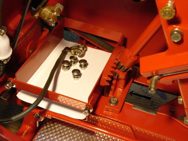

rmaynard 17,642 #4 Posted May 29, 2014 Did you replace the tie-rods with adjustable ones? If so, set the toe in about 1/8" after you check all the connections, tie-rod to spindle, and tie-rod to steering shaft. Make sure they are tight. Then check the front to back movement of the lower steering shaft. If it has a lot of play, it can be tightened up with shims on the shaft behind the lower steering support block. Share this post Link to post Share on other sites

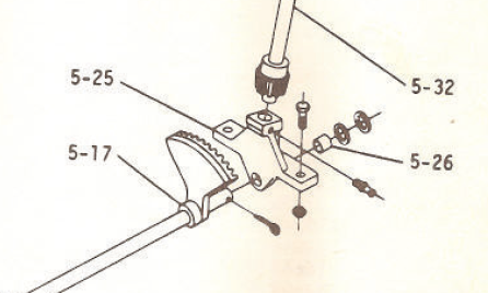

Anglo Traction 761 #6 Posted May 29, 2014 Fixed length Rods are ok, but if there are any inaccuracies in the welded Lower Rod joints, the wheels will be out of line. Adjustable rods allow the inaccuracies to be compensated for. Bob's description of shim adjustment above is located in the 'Arrowed' area below the bracket in this pic- or in Illustrated parts format- I had a lot of problems with steering errors on my 74 C-120/Raider project which I covered in the thread here a while back. Share this post Link to post Share on other sites
