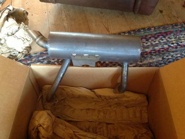

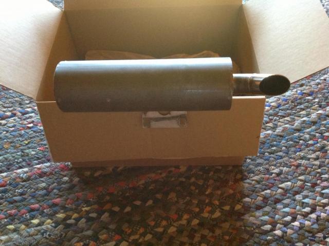

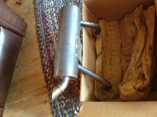

dennist 139 #19 Posted May 31, 2014 Yeah I couldn't believe the price. He started out at 250 for the pair but me being me had to offer lower. Even if the 520 turns out to be a carb issue I'm still going to do the valves and decarbon the heads this weekend. It should be nice and happy after that. The muffler is kinda beat too. after seeing the price of them I'm going to make my own. I have access to a full machine/fabrication shop and plan on making a full stainless one to factory specs. Any thoughts?Stainless muffler.... I am sure there are others, but look through this build. A couple pics of it now.... Share this post Link to post Share on other sites
wrightorchid 261 #20 Posted September 1, 2014 anybody making stainless for a magnum 12 (on a 312-8)? Share this post Link to post Share on other sites
cheesegrader 436 #21 Posted September 1, 2014 Man, I would love a stainless replacemet muffler. I think I bid on the one that dennist has, but he took it! If it still in the box, and not on the tractor, it would be really easy to send it to me! Share this post Link to post Share on other sites
