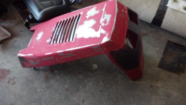

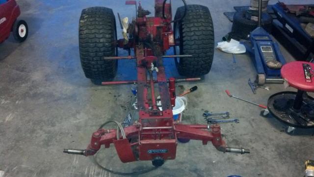

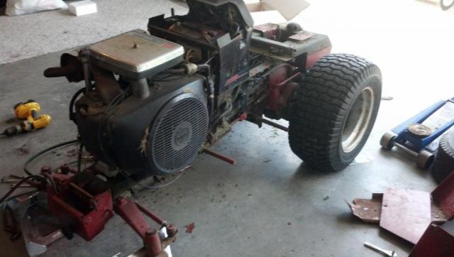

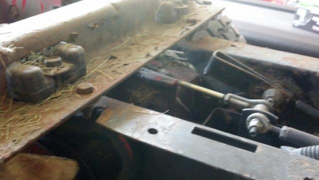

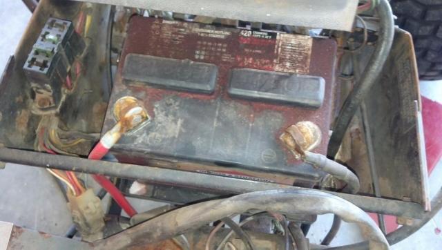

J HO 3 #1 Posted May 29, 2014 Started to disassemble my dads 520-H. This tractor has really been neglected for at least 15 years. Here are a few pics. Share this post Link to post Share on other sites
J HO 3 #2 Posted May 29, 2014 Lets try and load some pics again. 1 Share this post Link to post Share on other sites

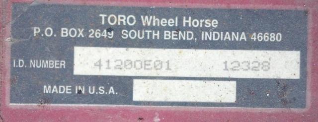

J HO 3 #3 Posted May 29, 2014 Can anyone give me some Information from the ID#'s? I know it has a 20 hp Onan Engine What Year? I believe my dad bought it New in 1989? 520-HC? Share this post Link to post Share on other sites
gwest_ca-(File Mod) 12,478 #4 Posted May 29, 2014 He could have bought it in late 1989 because it is a 1990 model. Go into the manuals a do a search for 41-20OE01 with a dash. 20 = engine hp O = Onan engine 01 = numbers zero one Garry Share this post Link to post Share on other sites
J HO 3 #5 Posted May 29, 2014 Thanks, I was having a hard time finding that information. 1 Share this post Link to post Share on other sites

edwroy 138 #9 Posted May 30, 2014 Toro parts look-up shows it to be a 1990. Share this post Link to post Share on other sites

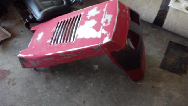

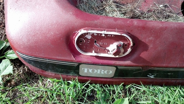

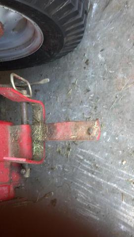

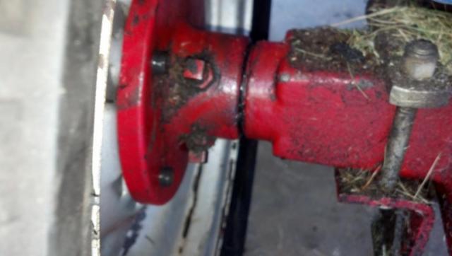

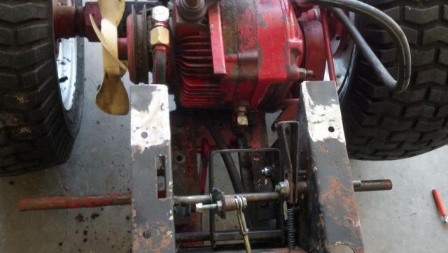

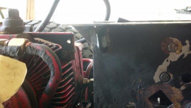

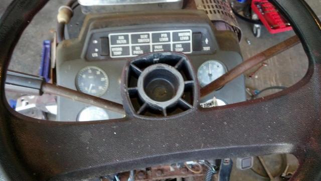

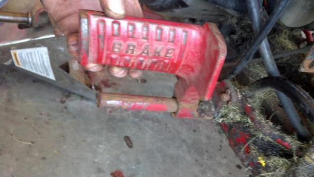

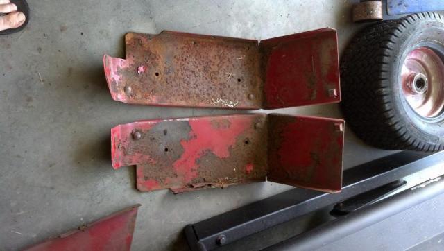

J HO 3 #10 Posted May 30, 2014 It has 970 hours. The engine has never been apart (it was still running great). I have not decided how far I am going with the engine it does show evidence oil leaking from the gaskets. What are some of your recommendations? Valve Seals and Gaskets? Here are some pics of things that need to be fixed or replaced. What are some suggestions on how to repair the sub-frame? Thanks J Ho Share this post Link to post Share on other sites
Tankman 3,528 #11 Posted May 30, 2014 (edited) Looks like my '90 520-8 before I restored the poor old Horse. After a complete tear down, I sand blasted all before painting. New decals from, of course, the Vinyl Guy. Have fun with the project and be sure, we need to know and see, to post updates. Good luck! Edited May 30, 2014 by Tankman 2 Share this post Link to post Share on other sites

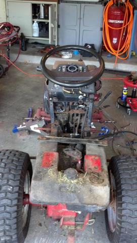

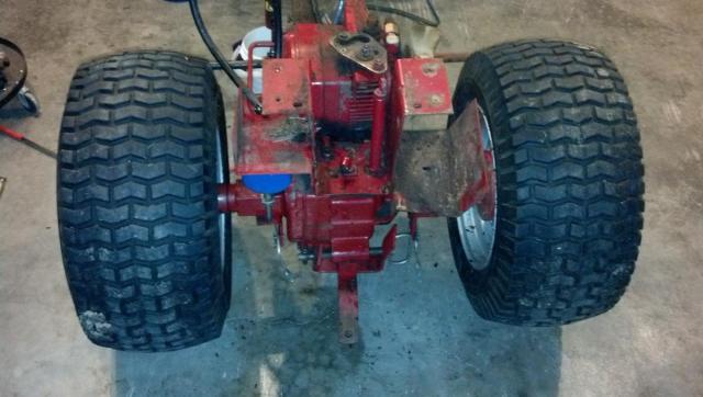

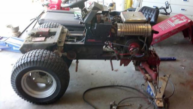

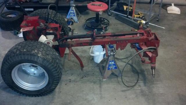

J HO 3 #15 Posted May 31, 2014 Continued with the Tear down. Share this post Link to post Share on other sites

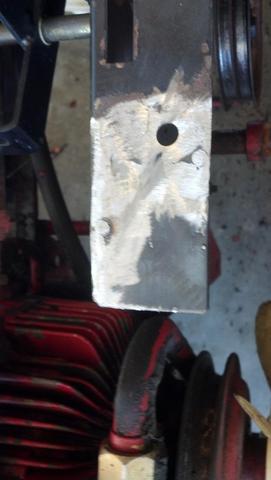

J HO 3 #16 Posted June 1, 2014 (edited) Here are some pics of my sub-frame repair. Original Bolts were tore out. Still have to mock up and drill holes. I added gussets for extra support. Edited June 1, 2014 by J HO Share this post Link to post Share on other sites
Martin 2,134 #17 Posted June 1, 2014 looking good so far!... one thing i would check with your repair in the last pic is does the belt guard fit right. maybe its just the position of the pic but it looks like you welded some sort of brace underneath the repair. the belt guard fits underneath that area and any extra metal is sometimes in the way. you maybe ok if back far enough to clear the belt guard. maybe you already considered that, but just thought id throw it out there...... 2 Share this post Link to post Share on other sites
J HO 3 #18 Posted June 2, 2014 Thanks, I still have to Mock it up. I tried not to have it stick much further down than the Bolt would stick. Share this post Link to post Share on other sites

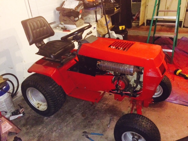

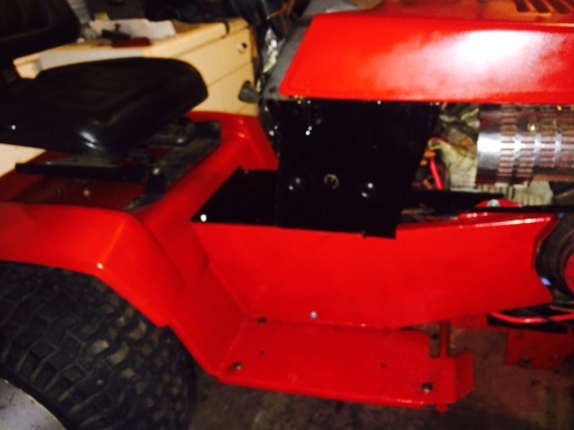

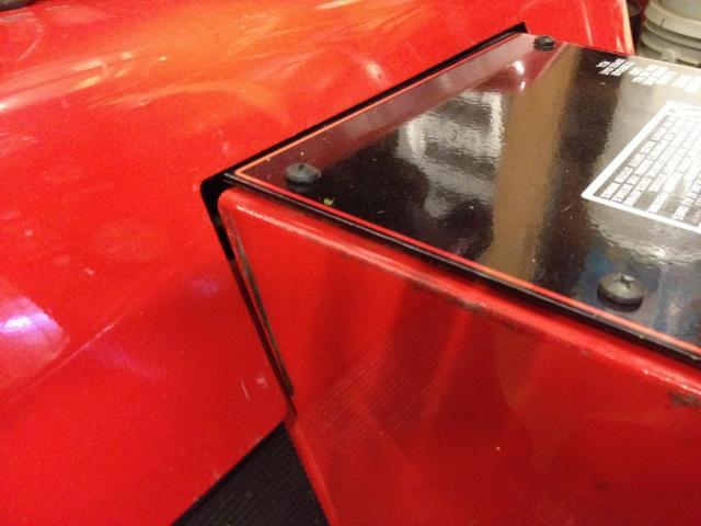

J HO 3 #22 Posted June 12, 2015 Its been along time but here are a couple new pics. I painted the Black front last night. 1 Share this post Link to post Share on other sites
