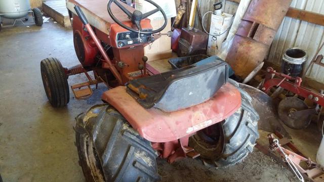

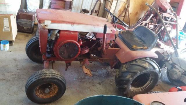

rustyoldjunk 127 #3 Posted May 28, 2014 The off set is wrong on JD wheels, Cub will be ok, and some other brands, but JD has a weird off set What Kelly said. The JD wheels are offset too deep because of the wider axles on the Peerless transaxle. Here is a Raider 12 that I am building from parts around here. Well the frame,dash tower and transaxle is still Raider 12. I have 23x10.50-12's on it. Not sure what the wheels were on originally. They do have a good offset for the tractor though. Share this post Link to post Share on other sites
