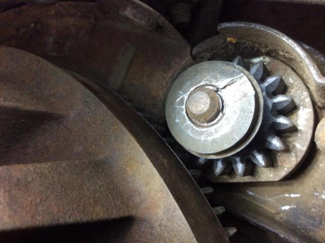

chazm 413 #1 Posted May 25, 2014 (edited) Have a 18hp biggs that keeps breaking the plastic drive gear /all looks good on the mounting & flywheel... Any ideas??? Edited May 25, 2014 by chazm Share this post Link to post Share on other sites
varosd 1,185 #2 Posted May 25, 2014 after getting my first "big" Briggs 18 hp on the workhorse, I found out they eat starter gears like a kid eating cotton candy at the state fair! OEM is the key as they seem to be made of harder plastic.. as long as everything is aligned correctly, it should be fine. After getting an OEM gear, my Briggs starts at the slightest turn of the key. So far....! 2 Share this post Link to post Share on other sites

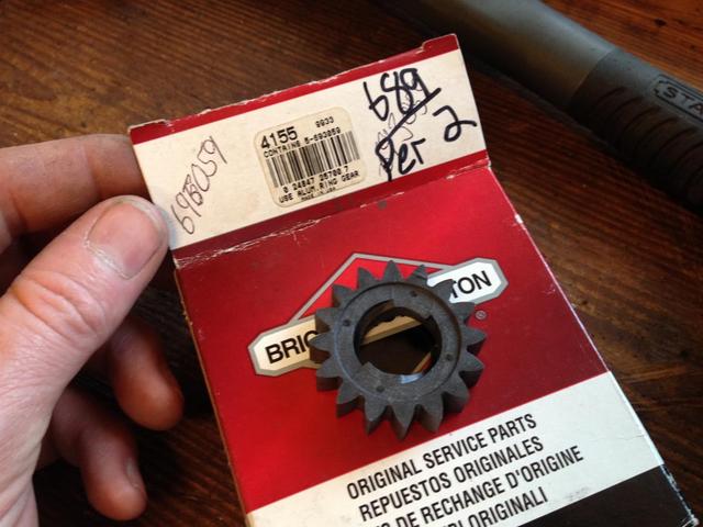

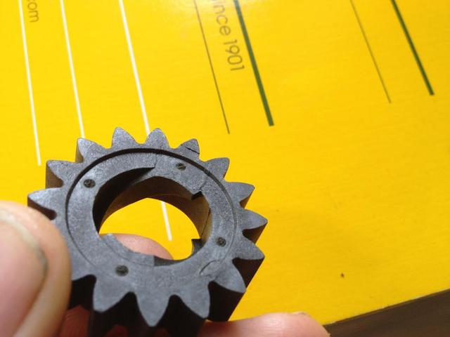

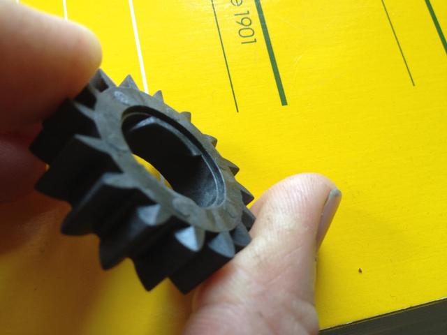

Martin 2,133 #5 Posted May 26, 2014 last time i had to replace one on the 1848 i picked up a box of two of them off ebay, they are cheap enough...... heres how mine looked.... and the replacement.... part number 693059.... 1 Share this post Link to post Share on other sites
Desko 645 #6 Posted May 26, 2014 The problem is your putting them on wrong or the person who had it first put it on wrong most people see the indented shoulder at the bottom and put it facing down when it should be facing up towards the flywheel 1 Share this post Link to post Share on other sites
Martin 2,133 #7 Posted May 26, 2014 just to clarify. the teeth on the leading edge have a bevel and that is what goes up or away from the starter. this is what 'meshes' with the flywheel. i can't comment on whether they are being put on right or wrong as there are no pics to show either. i do know the pic i showed of mine above was installed correctly, the gear had just worn out from old age...... just make sure you use an oem gear, the flywheel teeth all look good and you install the gear the correct way. the bevel on the gear teeth needs to contact the flywheel first when the starter throws out to mesh with the teeth on the flywheel...... this side faces out from the starter motor...... this side goes against the starter motor..... 1 Share this post Link to post Share on other sites

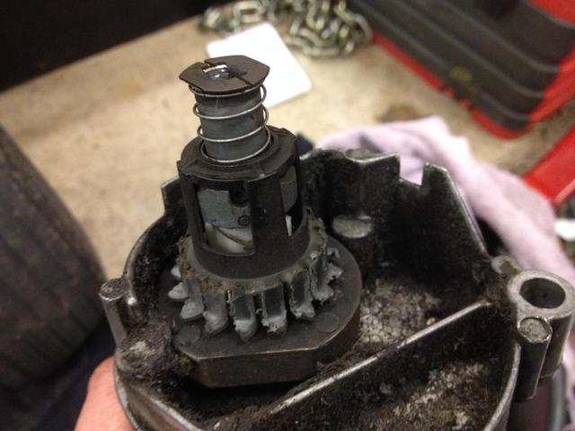

grandmas312 6 #9 Posted August 14, 2014 I just picked up a Snow blower that came with a GT-1848 with a worn out starter gear. My Question and its a dumb one. How do you get the gear off the starter to change it? my instincts tell me to knock out the roll pin, but it wont move. sprayed some break away on it and still not luck. Am I on the right track or is there another way? Thanks for any help in advance. Share this post Link to post Share on other sites
chazm 413 #10 Posted August 15, 2014 (edited) 1st off .... WELCOME TO Yep roll pin needs to come out, need to use a good pin punch the same size. Be sure to get OEM B&S gears , that took care of my problem Edited August 15, 2014 by chazm Share this post Link to post Share on other sites

timm6528 0 #12 Posted February 7, 2015 Stripped my starter gear trying to start the 1848 in cold temps, mine looks differant than the one pictured in above posts, had to pry out the inner ring than holds the end cap on, that allowed the gear to slide out. No pin to drive out on this one. Share this post Link to post Share on other sites
