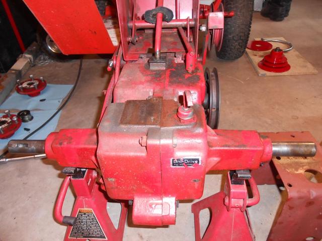

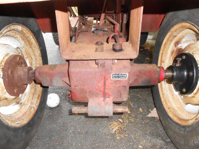

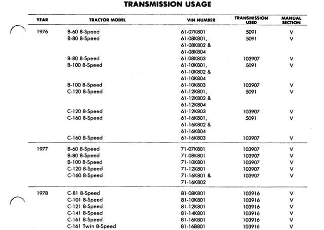

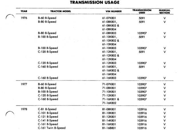

fireman 1,022 #12 Posted May 23, 2014 Just checked and the transmission in the 1976 B-60 has a dipstick. Okay here are the facts. The model number off the tag on the B-60 is 61-07K801 which confirms it's a 76' B-60. According to the chart in the picture below which is a screen shot from the transmission service manual it should have the 5091 which shouldn't have the dipstick. Only thing I can think of is the transmission was repaired or replaced at some time in the tractors life. The first picture is of the B-60. The second pictures is the C-160. They look identical to me! Share this post Link to post Share on other sites
rmaynard 17,221 #13 Posted May 23, 2014 Jeff, The 5091 did have a dipstick. That was a mistake in my first response. Share this post Link to post Share on other sites
fireman 1,022 #14 Posted May 23, 2014 Ok that answers that Share this post Link to post Share on other sites
