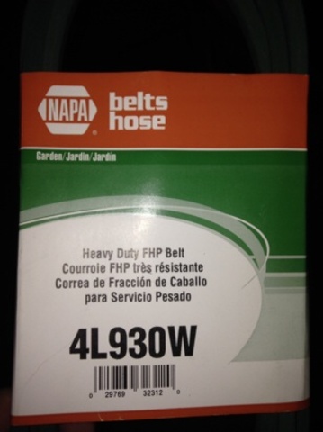

squonk 46,177 #7 Posted May 23, 2014 I use green Napa ( Gates Made in USA ) belts and they last for years. Share this post Link to post Share on other sites
leeave96 496 #8 Posted May 24, 2014 I use green Napa ( Gates Made in USA ) belts and they last for years.Do the green Napa belts you use part number start with 4L and end in W I've got another color tractor and have this belt to use. Don't see much info on them. Share this post Link to post Share on other sites
