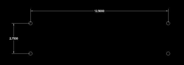

JUSS10 250 #1 Posted May 20, 2014 Looking to get the hole spacing for the plow mount bracket that would go on the rear axle of a round hood tractor. Looking for the distance between the holes that go around the axle as well as the distance from left side to right side. On center spacing would be great! Thanks! Justin Share this post Link to post Share on other sites
squonk 47,898 #2 Posted May 20, 2014 Are you trying to make a bracket? I have an old Round hood bracket that I plan on bringing to the show in PA. PM me if interested or I can get measurements. Share this post Link to post Share on other sites
JUSS10 250 #3 Posted May 22, 2014 I am looking to build an accessory that mounts to the rear axle but I want to make sure it lines up with the blade mount so I can use them together. Thats why I need the width and height on those holes. Thanks! Justin Share this post Link to post Share on other sites
squonk 47,898 #4 Posted May 26, 2014 Justin, Sorry it took so long to get back to you. The distance inside to inside of the brackets is 14 1/2 " The height of the bracket from the bottom of the ears to the top is 6 1/4". the hole height from the bottom of the ear hole to the top of the hole is 3/4 " On center spacing of the brackets that grip the axle is 12 1/2' and the center spacing of the attaching bolts is 2 3/4' Mike Share this post Link to post Share on other sites
JUSS10 250 #5 Posted May 27, 2014 I'm a bit confused by what you posted. Is this correct for the hole spacing? Also, what is the bolt size, 5/15 or 3/8? Share this post Link to post Share on other sites
squonk 47,898 #6 Posted May 27, 2014 Yes and the bolts are 3/8" This is for a short frame snowplow bracket. It's wider than the long frame ones. Share this post Link to post Share on other sites
