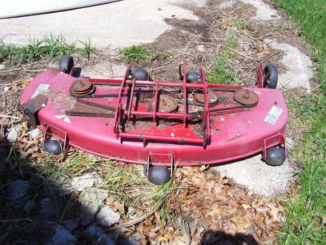

tommyg 157 #1 Posted May 18, 2014 I'm looking at bidding on a 48" mower deck that came off a 500H. Looks to be in great shape. Looks like there is still original paint on the bottom of the deck. Anyone know if it can be adapted to a D with the proper hanger? How about with the existing hanger? Seller posted a model number of 78355-5900001 & up. Not sure how to interpret that. Share this post Link to post Share on other sites
nylyon-(Admin) 8,835 #2 Posted May 18, 2014 That model number seems to be for a 42" Recycler deck, not 48", may want to double check. Share this post Link to post Share on other sites
tommyg 157 #3 Posted May 18, 2014 The accompanying photo says otherwise. Share this post Link to post Share on other sites
tommyg 157 #4 Posted May 18, 2014 Here's a picture of it. And yes, you are right about the recycler part. But this is not recycler. Share this post Link to post Share on other sites
nylyon-(Admin) 8,835 #5 Posted May 18, 2014 You're right, that is certainly not a recycler. Share this post Link to post Share on other sites
boovuc 1,090 #6 Posted May 18, 2014 Tommy, That deck was also fitted for a grass catcher. Notice the top pulley on the right side spindle and the accompanying bracket. Share this post Link to post Share on other sites
tommyg 157 #7 Posted May 18, 2014 Yeah, I see that. Didn't notice before. Still not sure if it could be adapted to the D series. Sure looks like it could. Share this post Link to post Share on other sites

tbarnhart 240 #9 Posted May 18, 2014 The deck that I originally had for my c-160 was a 5-1220 which shows to be a deck for a D-series. I assume the lift/attachment brackets were changed out for the c-series, but I think the basic deck shell is the same. My current deck is a 5-1210. It appears to be the same. I don't know what all the differences would be for the D-series because I've never seen one, but I think that deck would work with the proper brackets. Share this post Link to post Share on other sites
bmsgaffer 2,069 #10 Posted May 19, 2014 From what I understand from other posts in the past, it will bolt right up but you will need the correct hanger brackets from a D series deck.. Share this post Link to post Share on other sites
