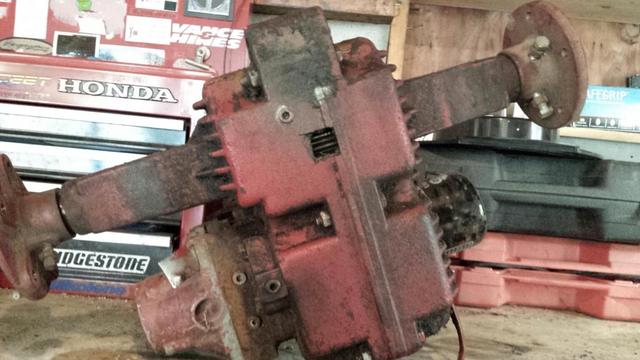

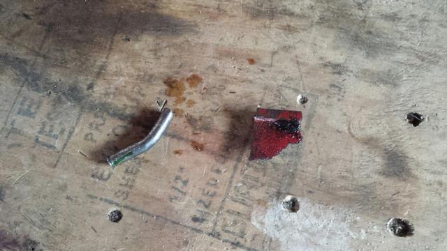

Michael Geraci 1 #1 Posted May 14, 2014 (edited) Need some quick advice... My C120 Hydro has served me faithfully for 20 years. Aside from a few parts here and there it has been great. Well taken care of and always serviced. Well, I go out today and start mowing. I noticed a couple of times that the tranny seemed to be "slipping". Almost as if the tires were spinning, but weren't. Literally, on my final pass, it started slowing down and finally stopped. No forward, no reverse. Get off and notice tranny oil pouring out of the transaxle. I first thought that the drain plug had come out, but upon further inspection, I notice a gaping hole in the case. After flipping my lid, I follow the oil trail back and found this in the grass... Obviously something came apart inside and came outside. I guess my question is: A. Do I attempt to find a used transaxle somewhere and try to repair a 40 year old tractor? I'm assuming that part is not from the pump. B. Try to find a newer model. Like a 416 or something?? C. Bite the bullet and buy something new? We all know what a "decent" tractor costs. Now way Im push mowing 2 acres. Edited May 14, 2014 by Michael Geraci Share this post Link to post Share on other sites

Michael Geraci 1 #5 Posted May 14, 2014 Nice huh?? daveoman... Give me a couple days to clean mine up and disassemble. I think my best option, if I decide to repair, is for you to ship one half of the gearcase and any other parts I need. Traveling to your zip would be an adventure and would cost me more in fuel than it would for you to ship the parts. thanks guys. This place is great. 1 Share this post Link to post Share on other sites
pfrederi 19,089 #6 Posted May 15, 2014 Differential bolt failed got wedged between the gear and the case and broke the case. You will need a left side case and new bolts for the differential (Grade 8 or 9) 1 Share this post Link to post Share on other sites
daveoman1966 3,880 #7 Posted May 15, 2014 You probably are right.... When you get it torn down, lemme know what parts you need. It will be helpful if you can send me a pic of the part(s) wanted and I would return to you a pic(s) of replacement part(s). In doing so, I've found it more expeditious to use regular emails. My direct email is: daveoman@windstream.net Just click that address to contact me. Dave Share this post Link to post Share on other sites
Michael Geraci 1 #8 Posted May 15, 2014 Thanks..I'll e mail pictures when I get I apart. Share this post Link to post Share on other sites
