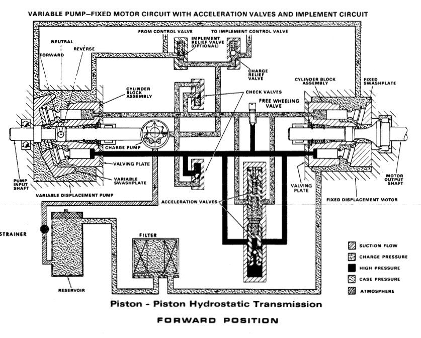

Save Old Iron 1,576 #12 Posted May 14, 2014 (edited) . Those hydro pumps have internal relief valves that prevent any more pressure through the system than it was designed for. So you wont get all 44hp to the ground. And i guess if it is in bypass mode all the time from trying to push around the extra 1k lbs then it will overheat and wear out quicker. The Sundstrand pumps will have charge pump and implement overpressure relief. I believe I read in the manual where not all styles of this pump (and there are a few different styles) have the hydrostat overpressure valves. Over pressure in the hydrostatic unit is usually never a problem as component wear introduces great pressure losses. Most older units have issues motoring around 1000 lb + D's never mind those weighing in at 2000 lbs +. Download the Sundstrand service manual from the manuals section and check to see what style pump you have and what can be reasonably expected from that particular style. Edited May 14, 2014 by Save Old Iron Share this post Link to post Share on other sites
Save Old Iron 1,576 #13 Posted May 14, 2014 hydro flow Share this post Link to post Share on other sites
Bill Frazier 2 #14 Posted May 14, 2014 Thanks guys for the help in understanding a little more about how the hydro works. I think I'll try the unit just to see how it does if it starts groaning I'll pull it, bag it, and shelf it. Share this post Link to post Share on other sites
