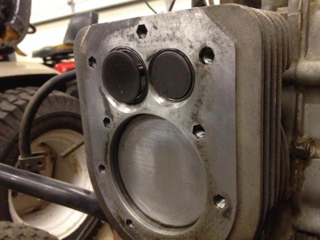

Martin 2,130 #6 Posted May 15, 2014 (edited) Don't want to spoil your great buy in any way but, I hope you realize that block isn't the same as a P220 as used on the 520 wheel horses. the head bolt pattern is a dead give away. the pattern on yours is the larger block NHE, T260, P224 style block. heres the P216 P218 P220 head bolt pattern..... Edited May 15, 2014 by Martin Share this post Link to post Share on other sites

seuadr 488 #8 Posted May 15, 2014 (edited) Don't want to spoil your great buy in any way but, I hope you realize that block isn't the same as a P220 as used on the 520 wheel horses. the head bolt pattern is a dead give away. the pattern on yours is the larger block NHE, T260, P224 style block. heres the P216 P218 P220 head bolt pattern..... IMG_2698.JPG i did not. looks like i need to shop around for the external bits for a p224! looking at your thread, am i correct in that it looks like a number of the tins and etc were usable? Edited May 15, 2014 by seuadr Share this post Link to post Share on other sites
Martin 2,130 #9 Posted May 15, 2014 parts are out there for them. you need to work out exactly what style block you have, points or electronic ignition. it will help with parts. I like the bigger engine style myself and its a typical Onan style engine, just on a larger scale. the height and width of them (from head to head) is what makes them difficult to install in a wheel horse. they are BIG. the oil pan and starter mount is different too. which means you have to use a bigger and taller pan than the performer engines as well. theres a pic of the oil pan on that thread......if you want to know any more i will try to help you out. I was impressed with how mine ran, i really need to finish off that thread, i had it running for 30 minutes or so and the bracket on the starter cracked and i didn't want to junk the flywheel...... so it has sit as i haven't had the time to get another starter and too much else going on with the 416 I'm rebuilding and so on....... what part number do you have on the top of the block. that would be a good start...... was that the 19.9 sears onan listing? Share this post Link to post Share on other sites

seuadr 488 #19 Posted May 17, 2014 (edited) just for posterity if anyone comes across one of these - this is verified as an N52M onan 19.9 - smallest of the "big block" onans, it has a shorter stroke than the T260 and the like at 2.64" instead of 3" it appears that ANY 10 bolt onan will be compatible for the vast majority of parts - so i think i may try to find a donor motor that has the good bits on it. i'll start a new thread if i get into building it. Edited May 17, 2014 by seuadr Share this post Link to post Share on other sites
