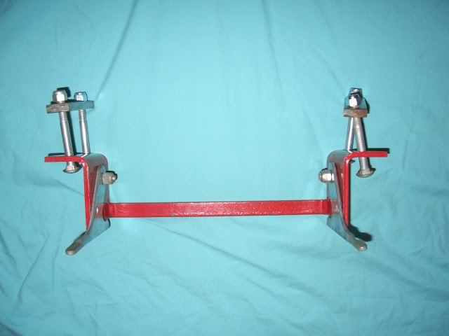

JimL 11 #20 Posted May 17, 2014 I am also curious how the snow plow mounts on the year of the tractor. Seems I don't see anything for the rod to mount to on the back of the tractor Share this post Link to post Share on other sites
Sparky-(Admin) 26,278 #21 Posted May 18, 2014 I am also curious how the snow plow mounts on the year of the tractor. Seems I don't see anything for the rod to mount to on the back of the tractor You need a rear axle bracket. Its for plow and tiller mounting. They are on e-bay all the time and I'm sure one of our vendors such as Kelly has one for sale. Mike........... Share this post Link to post Share on other sites

JimL 11 #25 Posted July 11, 2014 I got an axle bracket for the plow, does it go on the inside of the plow arms or the outside? My plow is worn on the outside of the bar that goes across the back but the bracket is too skinny to fit the outside. Bracket came off a 310-8… If it needs widened, ill just cut the bar in the middle and extend. Share this post Link to post Share on other sites
