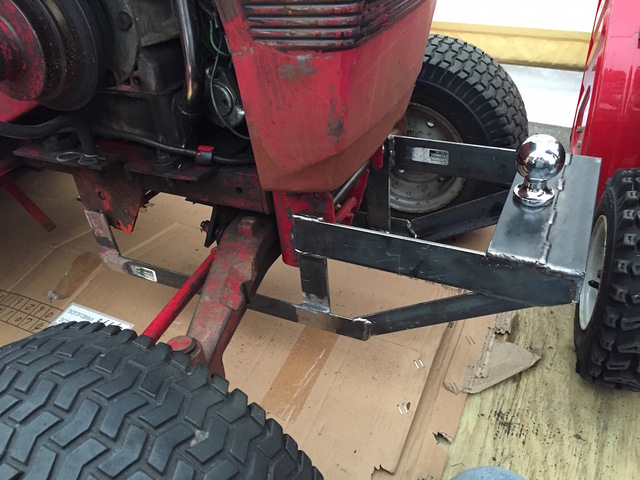

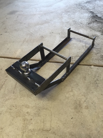

WNYPCRepair 1,924 #27 Posted November 7, 2015 (edited) @stevasaurus inspired me to try to make a front hitch. I needed to practice welding anyway, so this was a good project to start on. I left the front of mine square, as it may serve a dual purpose, I haven't decided. My welds aren't pretty, but they are strong. I had some trouble fitting it on the mid and front attach points, it was about a 16th too long. I was beating on it with a 5 pound sledge trying to bend it, and the welds held. I did finally get it to bend just barely enough to work.It started to rain as I finished, so the only tractor I could fit it on is the 520H buried in the tent. Edited November 7, 2015 by WNYPCRepair 3 Share this post Link to post Share on other sites
stevasaurus 23,816 #28 Posted November 7, 2015 Brian, that looks fantastic. I think the welds look pretty good. 1 Share this post Link to post Share on other sites
WNYPCRepair 1,924 #29 Posted November 7, 2015 Brian, that looks fantastic. I think the welds look pretty good. Thanks, I'm definitely getting better. Some of those were vertical, and I had never welded vertically. 1 Share this post Link to post Share on other sites
Ed Kennell 47,131 #30 Posted November 7, 2015 Looks good Brian. Burn about 1/2 lb of wire on vertical and you'll be ready to run overhead. 1 Share this post Link to post Share on other sites

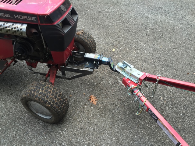

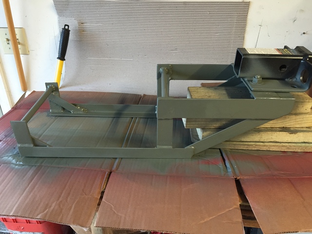

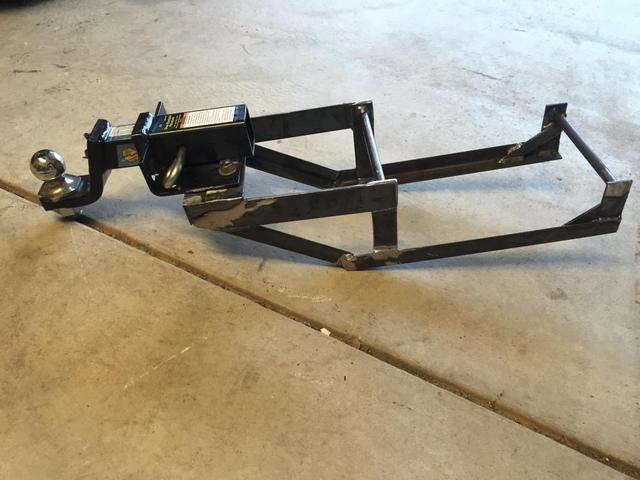

WNYPCRepair 1,924 #31 Posted November 8, 2015 Had to modify the hitch, it hit the trailer tongue when I turned. I didn't feel like drilling another 5/8" hole for the ball again, so I cheated. Added some diagonal bracing at the mid attachment point also.Quick prime job Works great now, I can get the tractor and trailer at a 90 degree angle to each other, and probably more. 1 Share this post Link to post Share on other sites
