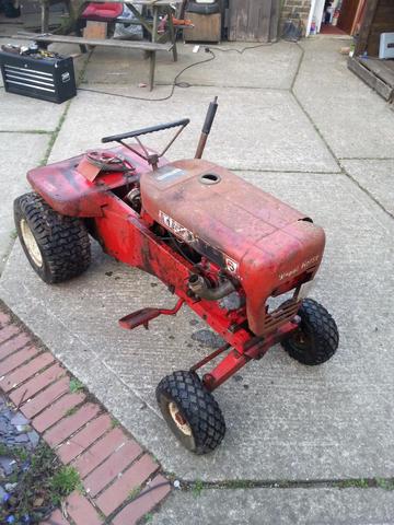

Charlie Smith 142 #1 Posted May 6, 2014 Hello All, I brought a nice little tractor back home with me Saturday, but haven't been able to post photos yet as my membership ran out! I'm now renewed and I'm a supporter again! Where do I start, well the man I purchased it from, said it wasn't his, it belonged to his dad, and his dad had used it to mow the fairly large laws they have. Until it was outdated by all the modern machines this little lawn ranger had apparently been sitting in the same spot for 15 years, he didn't know any other history but that, It took a while to load up onto the trailer, as all the tyres had bad flat spots so was bounced into the trailer, then strapped down and we was on our way home. It was only 45 minuites away but the journey home seemed to take forever, Once we was home it was unloaded, and pushed round the back just out of curiosity I plugged up the compressor and inflated the tyres, the two front tyres hold air, but the two rear tyres don't they hold air for a few hours then end up flat, The bonnet needs some work, needs some beating bending and shaping, and welding new slats for the grill need making up and welding in, all round, it shouldn't be too hard, but that's the fun of a restoration, The first job was take the bonnet off, and sit it too one side ready for the work that needs doing to it, Then we got too work with removing the cutting deck and cleaning up the seat! The girlfriend was even willing to help, (rare sighting seeing Robyn with a tool) Then the whole thing went for a wash, and was left to dry ready for work the next day, I then went to work cleaning out the fuel system where I was greeted by some thick golden syrup like petrol, I cleaned out the carb, filter bowl, tank and the lines, Then we wasn't getting a spark when we tried to start it up, so I then got to removing the flywheel and cleaning the points, As of now it runs and runs okay, just needs some tuning, once it's running perfect, I'm buying a new exhaust, getting the bonnet welded up and fixed, new tyres stickers painted etc, more updates as and when the work is done, Here's a few more pictures for you too all look at! 5 Share this post Link to post Share on other sites
neil 2,416 #2 Posted May 6, 2014 she is a real beauty Charlie and she certainly will turn heads, but then so will the lawn ranger. did you have to remove steering wheel to get hood off ? 3 Share this post Link to post Share on other sites
Charlie Smith 142 #3 Posted May 6, 2014 (edited) Yes, every time the hood needs to be taken off there's a pin that goes through the steering wheel with an r-clip just remove the r-clip slide the pin out then lift the steering wheel off, Edited May 6, 2014 by Charlie Smith Share this post Link to post Share on other sites

squonk 48,322 #6 Posted May 6, 2014 Love the Hot Rod exhaust! Share this post Link to post Share on other sites
