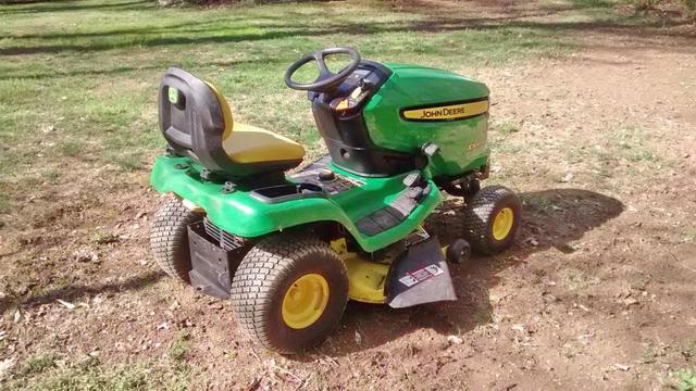

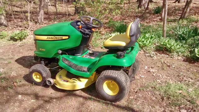

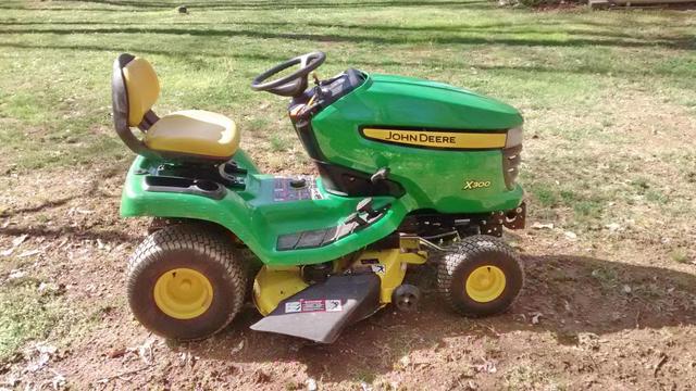

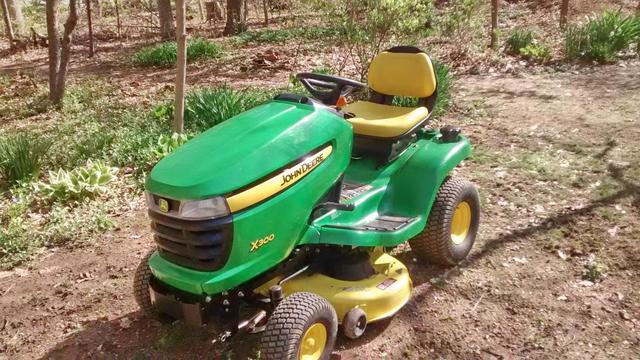

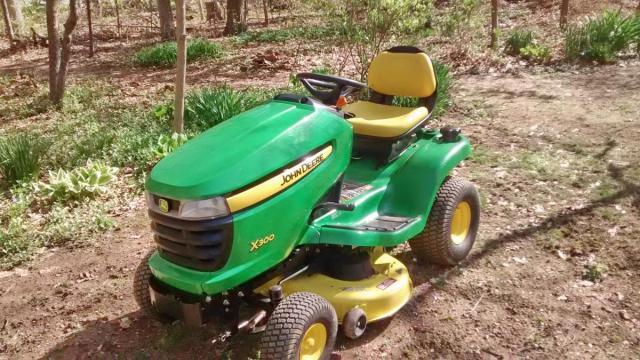

rmaynard 17,497 #1 Posted May 5, 2014 Last summer, my old John Deere 160 engine bit the dust, so I purchased a used Simplicity Broadmoor. Nice tractor, BUT, when I had my Cyclone Rake attached and was cleaning up leaves in the fall, I found that the mower deck would blow leaves out the front, making the dreadful job of leaf cleanup even harder. So, I put a for sale sign on the Broadmoor, set it out by the road, and within 4 hours it was sold and gone. Now, the task of finding another lawn tractor to use with the Cyclone rake with began. Since all of my Wheel Horses would require the purchase of a side discharge deck, and extensive modification in the hitch department to be able to haul around the Cyclone, I opted to go back to John Deere. My brother-in-law had recently gotten a JD X300 from an estate, didn't really need it, so he offered it to me at an unbelievable price. It's everything I need. 42" side discharge deck, 17HP twin cylinder OHV engine, hydrostatic transmission, and reasonably low hours. 3 Share this post Link to post Share on other sites
