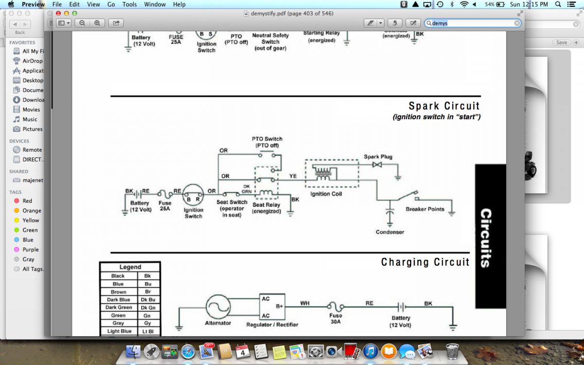

Martin 2,134 #9 Posted May 4, 2014 (edited) there is two safety switches at the pto. look at the one with the yellow and orange wire hooked to it. the seat switch is also hooked into this circuit and one and/or both circuits need to be closed for 12 v to get to the coil through the yellow. if either is jumped look at the connections to see if they are indeed connected...... heres the circuit from the demystification manual...... could also be a loose connection or bad wire. check the whole circuit just to be sure. the fuse is in that as well and could also be a connection issue..... Edited May 4, 2014 by Martin Share this post Link to post Share on other sites

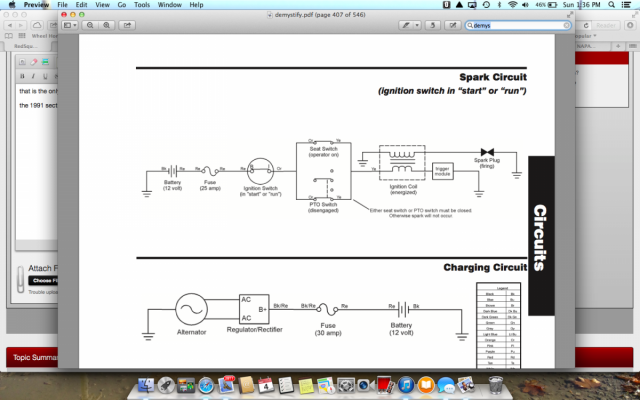

Martin 2,134 #11 Posted May 4, 2014 (edited) that is the only spark circuit in the 1992-1997 section of 416-8 and 416-H. its the same basic circuit to power the coil i would think..... the 1990-1991 section shows it with the trigger..... Edited May 4, 2014 by Martin Share this post Link to post Share on other sites
gwest_ca-(File Mod) 12,375 #12 Posted May 4, 2014 I don't know where they got the 1992-97 spark circuit. I saw the points and figured it was for a 1986 K-Series but they didn't use an ignition relay on them now that I check. 1987 used the M-16 so not correct for it either. I'll dig deeper on a clear day. It may make more sense. Garry Share this post Link to post Share on other sites
