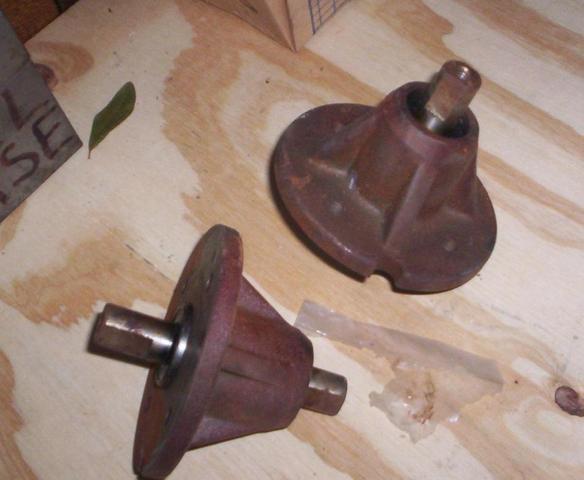

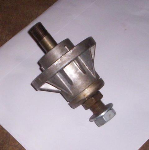

groundhog47 448 #5 Posted April 30, 2014 (edited) Does one of these pics look like your spindle, the first has bearings like Garry said, second has ball bearings. If pulley shaft on second is 5/8" and non keyed, metric; if 3/4" keyed shaft, standard bearing. Will get you a number. Poss the PO upgraded spindles like did on mine. Top bearing if 3/4" shaft: on ...MR01 diagram, #19=106085 unsealed top and bottom. Bot bearing if 3/4" shaft: on ...MR01 diagram, #25=106084 sealed bottom, open top. Top seal: on ...........................MR01 diagram, #17=106075 There should be a snap ring on bottom of spindle that retains bottom bearing, if not it's either ground off end (dirt and debris under cup will do that) or just missing, but necessary. Best bet remove bearing, carry to good bearing supplier and let them match, a whole lot less expensive, an you can remove rubber seal with a little sharp tool Save the seal as can also be added back). Bearings Limited #6203x3/4 2RSC3 PRX is what I purchased (not metric 6203). Seal: NOK AD8213E (Singapore). Take a shaft along If you have trouble finding seals or snap rings, or have a bad shaft, send me a PM. Edited April 30, 2014 by groundhog47 Share this post Link to post Share on other sites

gentle man farmer 0 #7 Posted April 30, 2014 mine looks like the second one want to thank every one for all the great info will get some pics of the old girl and post them i will be looking for lots of parts as I go forward Share this post Link to post Share on other sites
