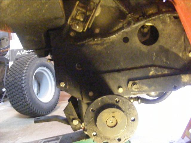

shallowwatersailor 3,222 #20 Posted May 2, 2014 To adjust the cam, you need to jack up the rear end, remove the rear wheels, and place it on jackstands. Adjustments are made with the tractor running. Make sure that it is secure because you need to lean under the fender to access the cam (it is too much of a tractor to come down on you!) There are complete directions in the Service Manual. It takes longer to jack it up than making the adjustment. The cam is in the large hole in the upper right. 1 Share this post Link to post Share on other sites
