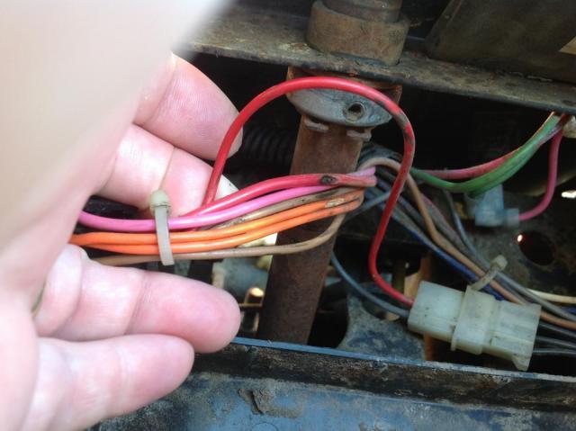

dennist 139 #2 Posted April 28, 2014 I fought and fought a similar issue bypassed all switches and if I moved the ignition switch back and forth a bunch it would finally fire up changed ignition switch did all other that I could think and finally pulled out these wires that rubbed against the steering shaft on the backside where I could not see them. No more issues for me...hope you find yours soon, as I have very little hair left after this one. 2 Share this post Link to post Share on other sites
