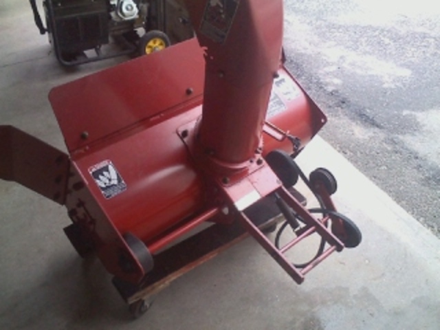

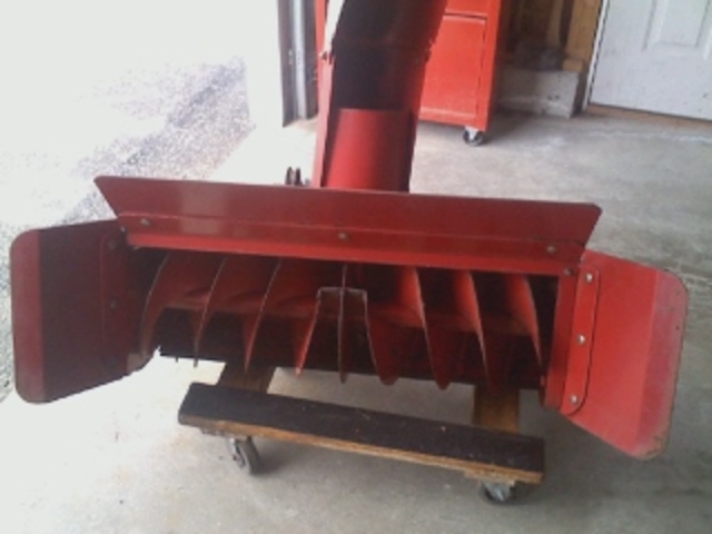

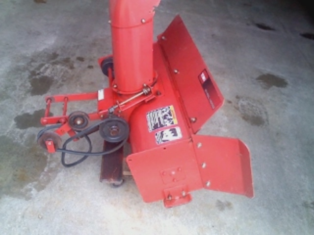

rexman72 210 #1 Posted April 27, 2014 I heard all the talk about how good these snow blowers do so I went out and picked one up this morning. 5 Share this post Link to post Share on other sites
Sparky-(Admin) 26,514 #2 Posted April 27, 2014 You'll love it, they chuck snow like crazy. One thing I noticed is that the side wings are mounted backwards on yours, undo 6 bolts and you can have em on right. Mike........... 2 Share this post Link to post Share on other sites

rexman72 210 #4 Posted April 27, 2014 yes I picked it up for real cheap money.When I got there and looked it over I couldn't believe how good it looked.The guy had it on a pallet and loaded it on my truck and I didn't even have to lift a finger You'll love it, they chuck snow like crazy. One thing I noticed is that the side wings are mounted backwards on yours, undo 6 bolts and you can have em on right. Mike........... Hmmmmm thanks for pointing that out.I wonder why they did it like that Share this post Link to post Share on other sites

RMCIII 840 #12 Posted April 28, 2014 Nice score... You will be very pleased with the performance of the single stage..... Mike, I think it is a your preferance, on how you want the side wings mounted.... I was told they mount them that way to draw additional snow into the auger and allow you to run the snow blower along things like fences and houses, without having to worry about scraping your tractor up... This does give it 6" or so of additional width, on each side, to ensure the blower get "curb rash" and not the tractor..... 1 Share this post Link to post Share on other sites
cod 136 #13 Posted April 28, 2014 Nice looking thrower and the only suggestion I'd offer is that when you mount it to your tractor, keep an eye on the pin you attach the lift rod to. I made the mistake of not checking mine and this past winter I wore mine ( the pin )down to the hole the cotter pin goes through. As a first time user it never occured to me to check it and I think it happened as a result lowering the adjusting wheels too much to improve getting the snow off my driveway. This summer I'll have to take it to a weld shop and see if they can add metal to the pin or perhaps mount a new one but this time I'll turn the pin upwards and keep it away from the pavement. Good luck - Cod Share this post Link to post Share on other sites
