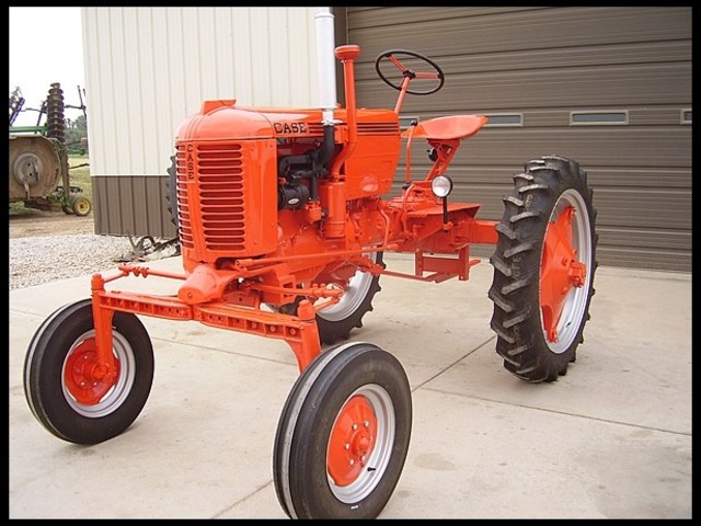

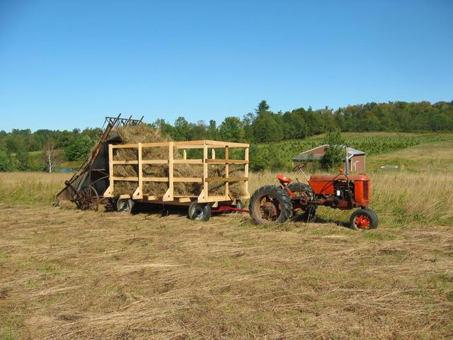

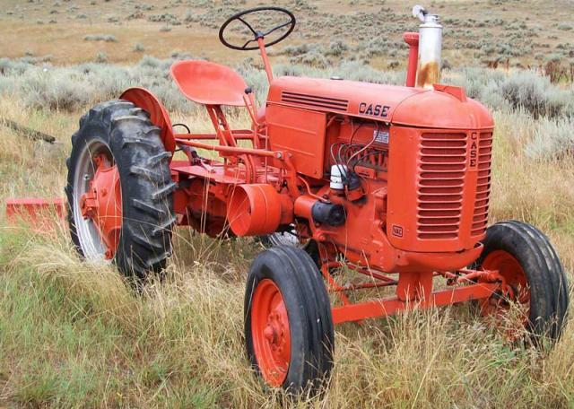

pfrederi 21,095 #11 Posted April 25, 2014 Back when farmers cultivated many Tractor companies made hi-crop or high clearance versions of their tractors specifically to allow cultivation of the taller crops. You can see the pictures of the two Case VA models below. Mechanically they were the same. Anyone want to try to modify a Wheel Horse to handle taller crops??? (Third picture is my own VAC...not nearly as pretty.... Share this post Link to post Share on other sites

jdleach 525 #13 Posted April 25, 2014 To get the proper terminology correct for those interested, the first Case in pfreden's post is a Hi-Crop. Note the tall front spindles, wide, conventional-type front axle, and high mounted rear axle with chain final drives. The second tractor is called a Standard Tread or sometimes conventional. Think Ford 8N style. The last Case is known as a Row Crop. Tricycle front end. Most Farmalls were of this type, such as the M, H, B, F-20, etc. Deere A and B, Oliver Row Crops, etc. There were even other styles of tractors such as Wheatland, Rice, Industrial, etc., but were all of limited production. From 1923 with the invention of International Harvester's Farmall tractor, later known as the Regular, the vast majority of tractors produced in this country by all manufacturers was of the row crop design until about 1960. Share this post Link to post Share on other sites
