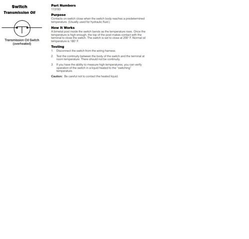

Larry 1 #1 Posted April 24, 2014 Has anyone installed a temperature gauge for monitoring the hydro temperature? I was considering removing the voltmeter which is of hardly any information and installing an automotive oil temperature gauge in this spot. I was wondering what the nominal temperature is for the hydro on a hot day so I select a meter with a good range. The voltmeter isn't needed, but feedback on when the hydro needs clippings cleaned out would be valuable. Share this post Link to post Share on other sites

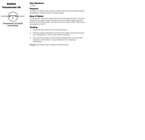

gwest_ca-(File Mod) 12,384 #3 Posted April 25, 2014 From page 3-38 of the Demystification Guide Garry Share this post Link to post Share on other sites

Larry 1 #5 Posted April 26, 2014 I put the mower blades on backwards once; it didn't cut too well and used a lot of fuel to cut the yard. . Anyway, the hydro collects a lot of clippings and is difficult to inspect. I thought a gauge would help me keep track of the temperature before it ran hot enough to turn on the idiot light. My hydro temp sender is broken, so it's time to do something about it anyway. Share this post Link to post Share on other sites
