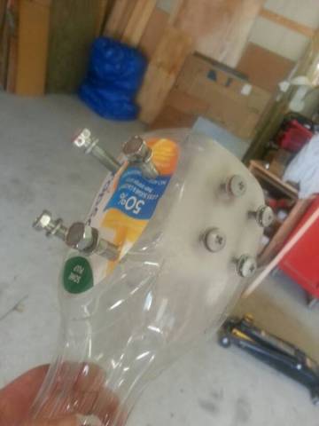

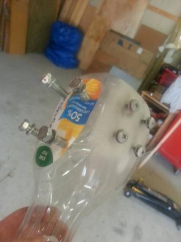

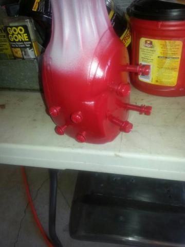

redrooster 83 #15 Posted May 28, 2014 When I recently painted some bolt heads I drilled holes in plastic jugs and screwed them in for a tight fit. This held them secure so I could easily move around to paint all sides. 2 Share this post Link to post Share on other sites
