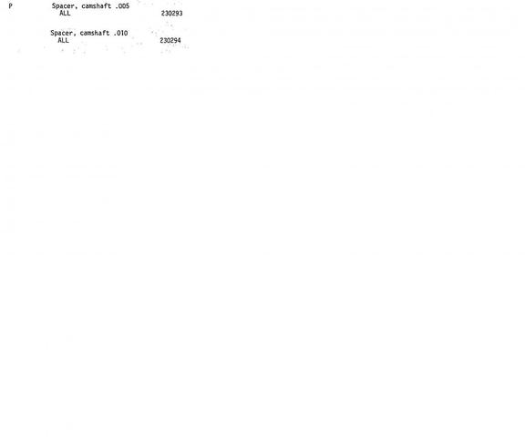

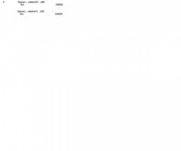

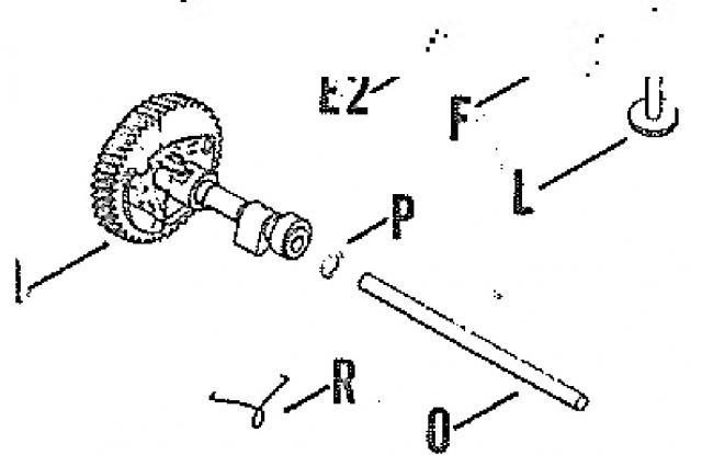

zanepetty 117 #1 Posted April 22, 2014 Hey everyone. I've not been on here in a while. I've been very busy with new work and some emergencies. Feels good to be on here and work a little bit on my tractor. My question is, does the cam shaft have some sort of washer or shim that prevents the shaft from moving around? Share this post Link to post Share on other sites
groundhog47 347 #2 Posted April 22, 2014 (edited) Per this manual, group 4, part id..P, spacer, camshaft, for all specs, there are two (one for .005 and one for .010). I would guess you determine side play an add whichever one or both to eliminate the out of tolerance allowable The part 3"s are 230293 (.005) and 230294 (.010) Hope this helps Thanks to turnahead72 for supplying the manual to WHRS Edited April 22, 2014 by groundhog47 Share this post Link to post Share on other sites

groundhog47 347 #5 Posted April 23, 2014 (edited) page 32, 33 Edited April 23, 2014 by groundhog47 Share this post Link to post Share on other sites
zanepetty 117 #6 Posted April 24, 2014 Thanks groundhog. That's awesome Share this post Link to post Share on other sites
