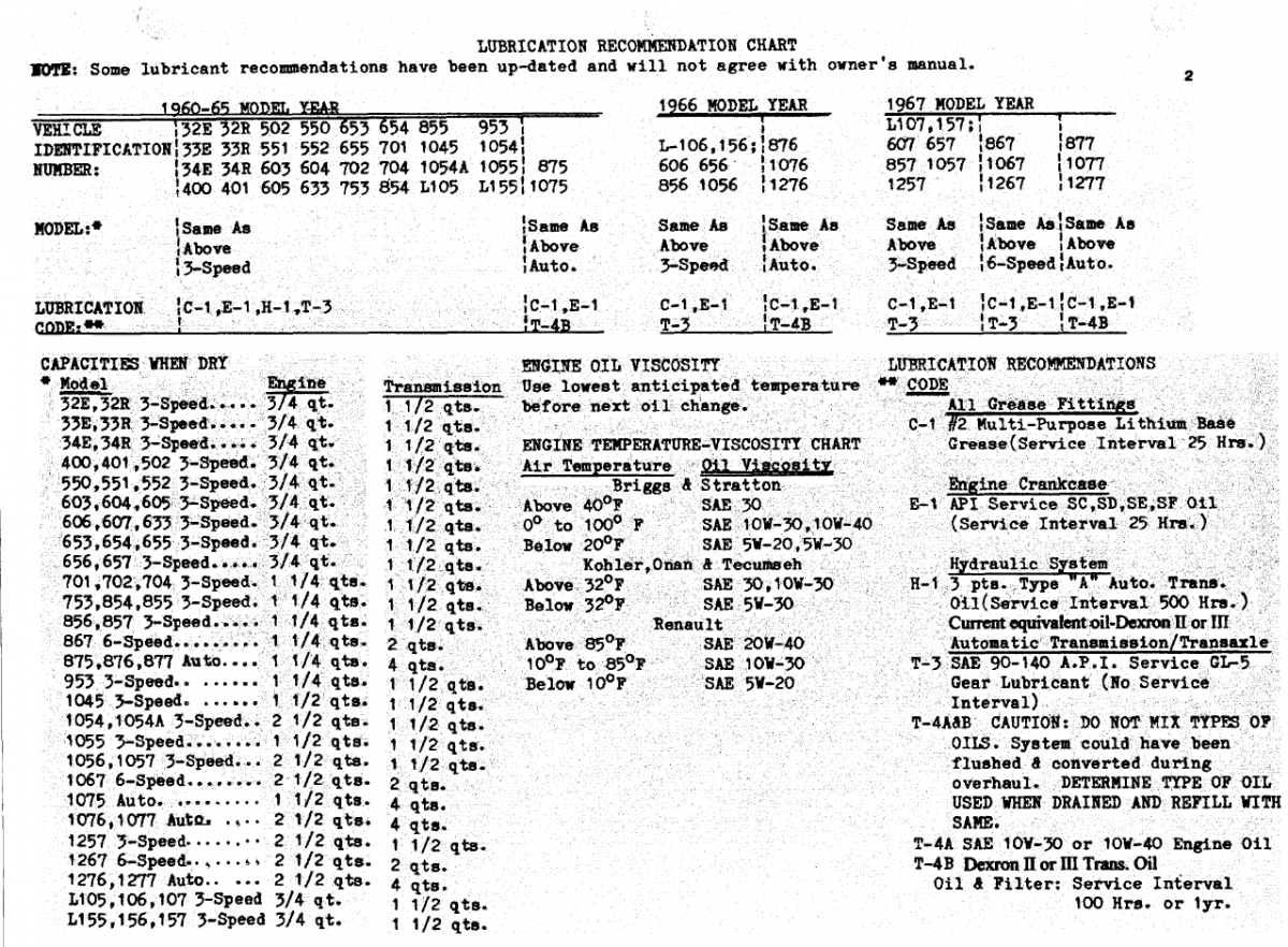

nyquil junkie 333 #4 Posted April 18, 2014 I read this right... SAE40wt motor oil goes in the transmission? it says "a good grade of SAE 40 oil...about 3 pints" I assume that means motor oil.... never heard of putting motor oil in a gearbox. Share this post Link to post Share on other sites
slammer302 2,157 #5 Posted April 18, 2014 80/90 at will work just fine Meant wt Share this post Link to post Share on other sites
rmaynard 17,634 #6 Posted April 18, 2014 (edited) I read this right... SAE40wt motor oil goes in the transmission? it says "a good grade of SAE 40 oil...about 3 pints" I assume that means motor oil.... never heard of putting motor oil in a gearbox. In 1998, Wheel Horse (Toro) published a chart showing belts and lubes for all models. The chart shows the following lubrication info for your 856. Please note at the top the line that says "some lubricant recommendations have been updated and will not agree with your owners manual" Also, just in case you haven't found it, there is a drain plug on the bottom left rear of the transmission. It is a plug that is removed with a 1/4" Allen wrench. It is usually missed because it is covered with a mixture of oil and dirt. Clean all the junk out of the hole so the wrench goes all the way in. All of my transmissions that do not have a dip stick/fill hole, I remove the shifter and pour the fluid in there. Edited April 18, 2014 by rmaynard 1 Share this post Link to post Share on other sites
