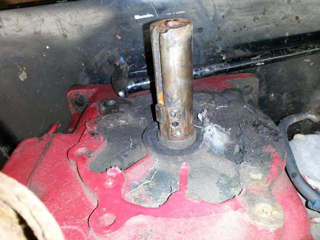

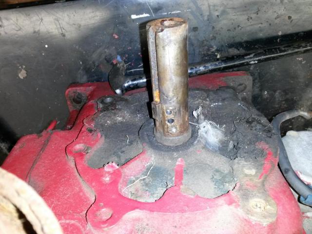

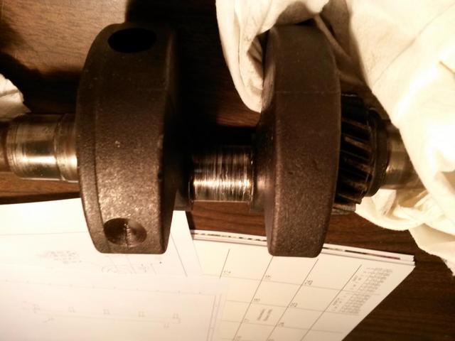

SousaKerry 503 #1 Posted April 14, 2014 Well it all starts with an HH60 I had in the Wife's Lawn Ranger, I rebuilt this engine last winter and while it ran fine it smoked something terrible. So I tear it down hoping for a simple fix. Well I was wrong bore was just too big for the rings to make up, oversize pistons are scarce as hens teeth and priced to match so no sense in throwing good money after bad engines. Time for a Kohler I thought I had 2 Kohler K-181's so I took one to work, cause it had less oil on it, and start to tear it down crank was tore up pretty bad and had some holes drilled in it as well so I quickly grabbed the crank out of the second engine. Had the whole lot sitting in the hot tank at work for several days and start cleaning things up that's when things get worse. Found a crack in the block that had been welded, badly. then I go to mic the bore and low and behold it is not an 8HP it is an early 7HP with the 2 7/8 bore not the later 2 15/16 bore. So in comes Engine number 3 (already stole the crank.) I mic the bore and it is about .012" over so we will hone it and see what happens. The thing is covered in grease and oil so who knows what is hiding underneath. Share this post Link to post Share on other sites
