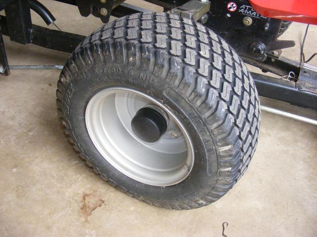

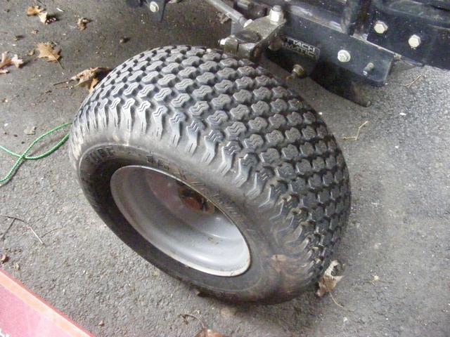

shallowwatersailor 3,222 #7 Posted April 14, 2014 I have Titan 16x7.50-8 tires on my 518xi, and Kenda 16x7.50-8 on my 520xi. The Kenda's are larger by close to an inch in diameter and a wider tread as well. Titan Kenda Share this post Link to post Share on other sites
Red-Bovine 337 #8 Posted April 14, 2014 Thanks for the pics! Are you finding that the Kenda tires are easy on your grass? They are supposed to be round shouldered and easier on turf in the turns. That is what I am hoping for. The tread also look's like it might be better for steering in the snow during snow removal. Hoping for that, too. Red Share this post Link to post Share on other sites

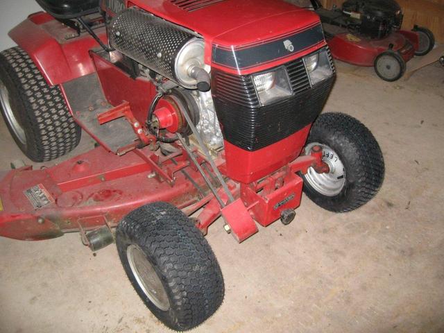

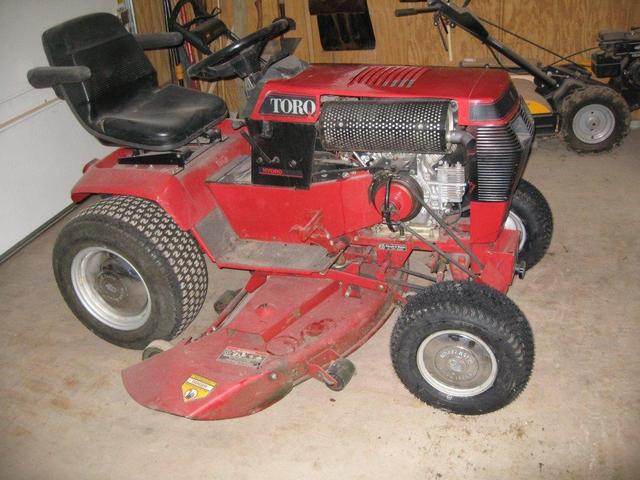

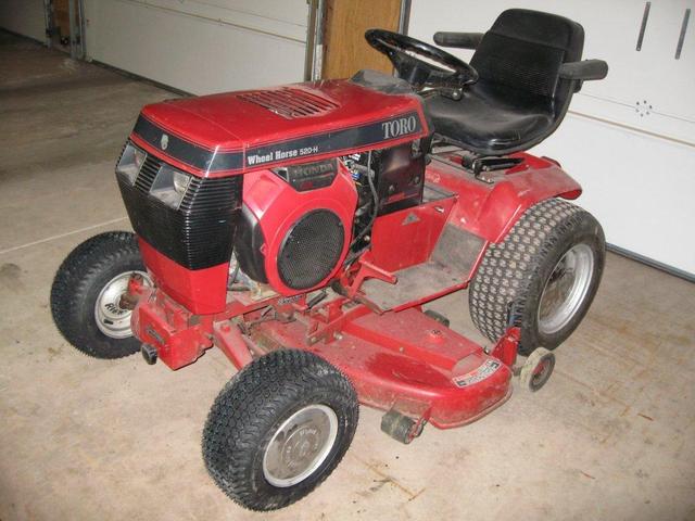

Red-Bovine 337 #16 Posted April 17, 2014 Had a chance to get to those Kenda tires today. I had Walmart mount them for me. That was a treat not to have to be breaking beads and stretching tires on and off tiny wheels. I was pleased to see roller bearings when I took off the wheels. I thought they might be bushed and it was nice to see real bearings. So I cleaned and repacked those right away. The Kenda's were a bit scrunched up when I received them, but the air quickly puffed them out to their normal shape. They look real nice and have the wide footprint I had with the old Dico tires and the nice round shoulders. Should be a great set of tires. I forgot to get a pic of the old Dico's, but here are some of the Kenda'a. And you can drool a little over that nice Honda GX630, too!! Red Share this post Link to post Share on other sites
leeave96 496 #17 Posted April 17, 2014 Those tires look great! Especially like the hub caps! But.... Isn't it time for that tractor to get a bath... ;) Share this post Link to post Share on other sites

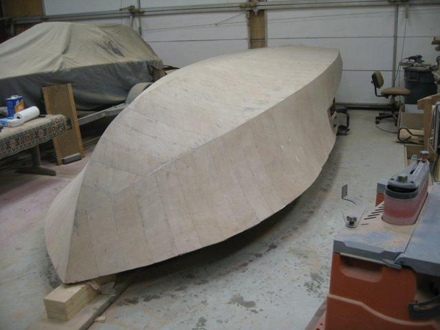

Red-Bovine 337 #18 Posted April 17, 2014 Yes, it needs a bath for sure! Mostly it's dusty from the sawdust and sanding dust from the woody boat I'm building. Red Share this post Link to post Share on other sites
JERSEYHAWG / Glenn 4,590 #19 Posted April 18, 2014 Boy red. You have gotten good service out of that 520. Thanks for updating and the pics. Don't forget some snaps of the boat when done. Glenn Share this post Link to post Share on other sites
The Walri 4 #20 Posted April 18, 2014 Nice looking boat! Love to see/hear more about it. Sent from my SCH-I545 using Tapatalk Share this post Link to post Share on other sites

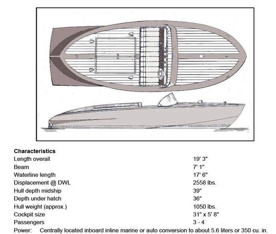

Red-Bovine 337 #21 Posted April 18, 2014 (edited) Thanks, guys! Yup! The 520H has been a very good investment. I feel kinda bad about the Onan motor, though. When running right it was a very good motor. I just got tired of the valve issue. I fixed one cylinder, then the other a few years later. When it happened the third time, that was enough for me. The Honda motor has been very good, though. Breathed new life into this tractor. The boat is a Glen L Torpedo. This is the last design Glen did before retiring (age 92). There were some issues with the patterns and the plans were pulled from their lineup. I re-lofted the design and made numerous corrections while in progress in the building. It is a 19' 3" inboard runabout reminiscent of the older Ventnors. The hull has been planked using the "cold molded" epoxy/double diagonal plywood method. Many boats are now built this way and are planked with 1/8" Mahogany to simulate the Chris Craft style planking. This boat hull will be fiberglass coated and painted, but the deck will be a classic woody style. The lines of the boat lend better to painting rather than planking the hull. It will be powered by a 300 hp Mercruiser inboard motor. This may be a one of a kind boat as no one else is building one nor is there one already built. My Hubby thinks I'm crazy for all the building I have done (planes and boats) but he loves me and all my idiosyncrasies. Red Edited April 18, 2014 by Red-Bovine 1 Share this post Link to post Share on other sites
