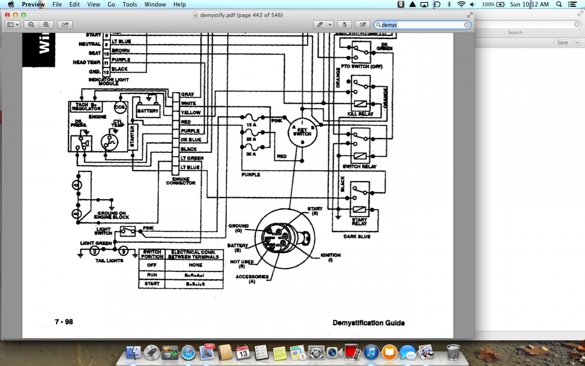

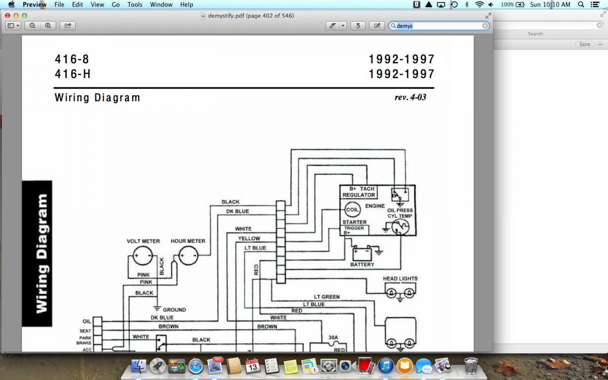

Martin 2,134 #3 Posted April 13, 2014 (edited) first pic shows the 416 (p216) engine harness, second shows the 520 (p220), the only differences i see is on the 416 9 pin the tach and cylinder temp wires aren't connected to anything. the best thing i would suggest is since you have both harnesses compare them. get the plugs oriented the same way (some of the pin holders on the connector are round and some have flat spots to key the plug a certain way) and see if they are the same........ Edited April 13, 2014 by Martin 1 Share this post Link to post Share on other sites
