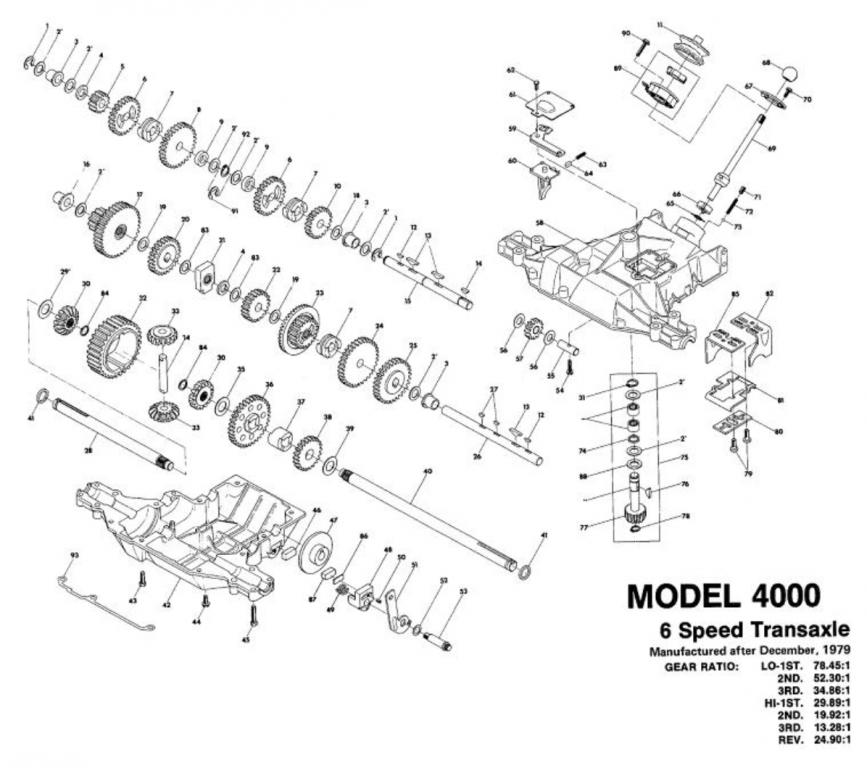

@stevasaurus I picked this transmission up from Frank last night.  You’re right, he’s good people!  Next time we cross paths, be ready for a cool little project!  It’s much lighter than the cast iron cousins we’re used to.
Here’s an exploded view I found on the google machine :handgestures-thumbupright:
