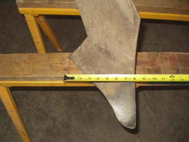

groundhog47 448 #1 Posted April 12, 2014 Perusing through previous posts with no answer found, what is/are dimension(s) that determine whether a Bottom Turning Plow is 8", 10", or 12". Thanks for any help and for "Why does it matter", it's preferential for me to call implements/parts by a proper name. Share this post Link to post Share on other sites
posifour11 723 #2 Posted April 12, 2014 Found this picture a while back. Hope it helps. Not my picture. 2 Share this post Link to post Share on other sites
daveoman1966 3,884 #3 Posted April 12, 2014 Wheelhorse names this item simply as 'plow' or 'plow with coulter'. A more 'archaic' or farmers' name is 'moldboard plow'. The 8, 10, or 12" refers to the cutting width of the furrow. Share this post Link to post Share on other sites
squonk 48,225 #4 Posted April 12, 2014 I have 2 plows made by Brinly and they have an " 8" stamped into the back. It's measured like posifour's pic shows Share this post Link to post Share on other sites
groundhog47 448 #5 Posted April 12, 2014 Ok, shuda fig'd that out "turnin plow" throws open a furrow so to speak turnin' it over, "Who'da thunk it" all. Share this post Link to post Share on other sites
