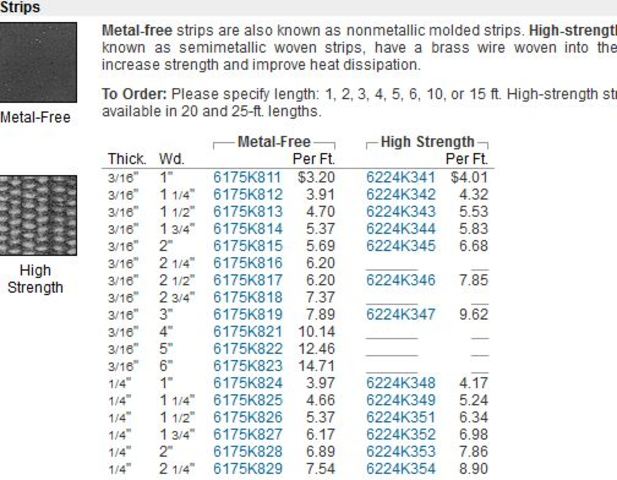

pfrederi 21,295 #2 Posted April 9, 2014 (edited) You can buy brake lining (no asbestos) from McMaster and other places. Drill countersink and rivet. (I would wear a mask getting the old lining off as I am not sure back then if tehy had asbestos or not. I use metal free for PTO brakes and fro belt pulley brakes. McMaster will have rivets also http://www.mcmaster.com/#standard-rivets/=rgqoib Edited April 9, 2014 by pfrederi Share this post Link to post Share on other sites
