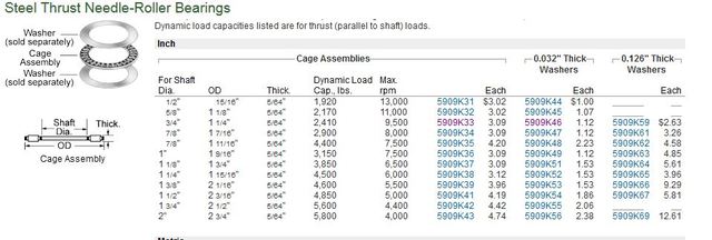

daveoman1966 3,884 #4 Posted April 8, 2014 (edited) Install a THRUST BEARING like thiis one in the two front wheel spindles....between the cast iron axle and the 3/4" vertical spindle shaft. A pack of the just sold on ebay. # 9862 may or may not be the right part number...but it is a bearing like this that will help with the steering. Edited April 8, 2014 by daveoman1966 3 Share this post Link to post Share on other sites
MalMac 1,336 #5 Posted April 8, 2014 I put those thrust bearings on my tractor with a Ark Loader and in with less than 4 hours operating time they had been reduced to a grey slime powder. Could not hold up to normal usage let alone getting a few heavy buckets of top soli. The bearings are just to small for the application. Maybe a little larger one would hold up better. 2 Share this post Link to post Share on other sites

gwest_ca-(File Mod) 12,354 #9 Posted April 8, 2014 There should be a hardened washer each side of the thrust needle bearings. Torrington thrust bearing catalog (15 pages of 356) Garry 3 Share this post Link to post Share on other sites
pfrederi 20,870 #10 Posted April 8, 2014 (edited) The thrust washers and hardened flat washers are available from McMaster for less money than ebay. Your C160 only has 3/4" unreinforced spindles. If you are loading the bucket up so much that it is too hard to steer you are probably well on your way to bending them. People need to remember these are garden tractors with a loader not a skid steer or purpose designed construction equipment. A bucket full of mulch is one thing, fill it up with gravel/sand you are going tp break something sooner or later.....Take smaller loads http://www.mcmaster.com/#needle-roller-thrust-bearings/=rg7wly Edited April 8, 2014 by pfrederi 2 Share this post Link to post Share on other sites

fireman 1,022 #16 Posted April 9, 2014 The thrust washers are a must! I put these on my D200 with loader and backhoe and they worked fine. The bearings need the hardened surface to roll on! Make sure you put one below and above the bearing. Share this post Link to post Share on other sites
