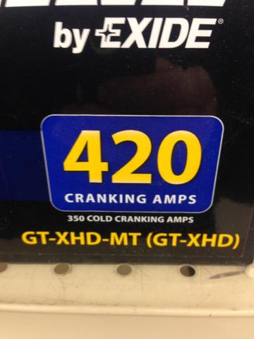

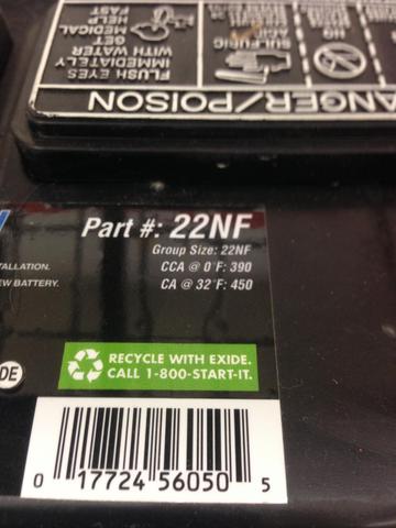

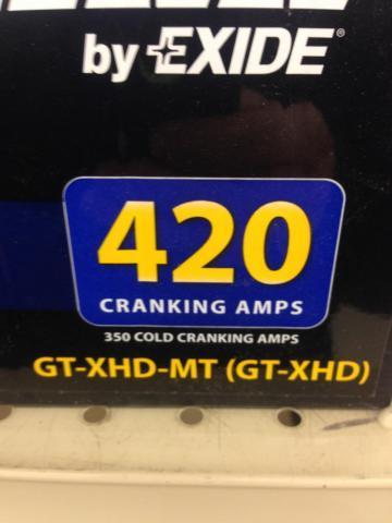

Hodge71 691 #1 Posted April 7, 2014 (edited) So its that time..I have been putting it off exponentially.... With much dread I went battery shopping today as I have 3 tractors that need new ones. I came home confused as all he** and with no batteries. Heres the issue I have....22NF as close to OEM as I can find. Its the exact dimensions required for the 1970 Charger 12 and then 1974 C-160 8 speed and probably for the 18 auto as well.... Exide 450 CA 390 CCA and heres the kicker $129 each!!! After I picked up my jaw and found my wallet as it shot right out of my pocket and made a beeline for the front door of TSC, I kinda wondered around in a fog doing math and trying figure out how to add 129+129+129 and not end up with $387+tax and a mild coronary....then figuring $50 for each dead body I pick up and mumbling theres no way I can justify 8 dead people for 3 batteries. I see a display with shall we call it option #2: Same company (Exide) but these are called Lawn and Garden and look so small it should be on a rear engine rider. I find one with 420 CA and 350 CCA.... but the price a much more reasonable $44 each.... doing the math quickly I come up with only 3 dead bodies for 3 batteries...phew.... more palatable. The question I have for the powers that be is...What makes the big 22NF worth 130 buck with 450 CA and the little toy battery is 420 CA and only $44...teach me about these things so that I can make a wise decision. The last thing I want to do is buy 3 batteries that will only last year or not be big enough to crank these tractors over..... I would imagine that the bigger battery has more reserve capacity but not sure if its worth it and if I need any reserve capacity at all..... Edited April 7, 2014 by hodge71 Share this post Link to post Share on other sites

Save Old Iron 1,573 #10 Posted April 8, 2014 (edited) This isn't going according to plan...I was looking more for a reason as to why the 22NF was so much more expensive and what the differences were even though the L&G is half the size and the CCA are practically the same Hodge, I'll take a shot at your question without giving you the weather forecast or my favorite recipe for scrambled eggs !!! CCA is a 30 second measurement of how any AMPS the battery can delivery under certain environmental conditions. . Comparing the two batteries you talked about is like comparing an AA flashlight battery with a D cell battery. In near short circuit usage, both can deliver about the same amperage over 30 seconds. But what happens beyond that? The D battery has more staying power due to it's physically larger size. This "staying power" is RC or RESERVE CAPACITY. If you can find the RC for both the batteries you mentioned, you will find them significantly different. No way you (or anyone) needs 400+ CCA as your starter may only draw 50 - 100 amps max before burning out internal wiring and components. The more expensive battery has more and thicker plates inside allowing for a large CCA rating (many plates) and also a larger RESERVE CAPACITY (thicker plates). So Chuck, then I should go out and find the largest RC battery available. Well no. If your tractor will not start in the first 30 seconds of cranking, you may need to investigate other issues with the engine. So all wrapped up, lawn and garden applications do not really need large RC or CCA with a properly tuned engine. The physically larger battery just has more material to degrade before it dies. You interpret this as longer life because of the meager requirements needed to start a small single cylinder engine. I believe the success folks have with larger batteries is strictly due to more / thicker plates that take longer to degrade. That's it. Those who can get 5+ years from batteries are just exercising common sense in using and storing the batteries. Don't run a battery dead until your starter stops cranking. Once a battery goes below 10 volts - its functionally dead and irreversible damage starts on the lead plates. Zapping the dead battery on a 200+ amp charger does more irreversible damage with plate warp, etc. Don't drain a battery below 10 volts - stop cranking and SLOWLY recharge it. Don't store it uncharged in the cold as electrolyte will freeze and warp plates. Common sense stuff that few of us practice. So we see each other at TSC every 2 years and fight over the last LG battery with the proper terminal configurations. Edited April 8, 2014 by Save Old Iron 2 Share this post Link to post Share on other sites

squonk 47,286 #13 Posted April 8, 2014 SOI I've been preaching that for years. I see all these guys wanting 400 + amp battery's for their GT 's. And then expect those 400+ amps to flow thru those puny starters and 6ga. worn out cables! Sent from my iPhone using Tapatalk 1 Share this post Link to post Share on other sites

Save Old Iron 1,573 #18 Posted April 8, 2014 So from what you both are saying...the factory put batteries in that were way too big and not needed. I guess Im gonna be buying the little tiny ones and shoving 2x4s and plywood in so they dont vibrate to death Unfortunately. if you start going too small, you loose RESERVE CAPACITY by virtue of smaller physical size. Reserve capacity is necessary if you are going to consider additional lighting or adding electrical accessories such as electric lifts. Did the factory use batteries that were way too big? Probably, for 90% of buyers who only cut their 1/2 acre in the summer and store the tractor over the winter. Im sure the conversation on the design floor was centered around the fact that a "too big" battery was also a very common battery, used widely and available widely in the automotive market and as such was less expensive to purchase in bulk than "the right battery". A;ways go with RESERVE CAPACITY in the LGT arena. CCA is secondary and certainly anything near 400 CCA is useless unless it happens to get you a better reserve capacity. Good luck finding RESERVE CAPACITY ratings. This is the one true way to tell the good from the marginal and therefore is the rating most likely not to be listed for a battery. 1 Share this post Link to post Share on other sites
squonk 47,286 #19 Posted April 8, 2014 For your into. A 5022NF has a 58 min. Reserve capacity and a 6526 has a 55 min capacity. The higher grade group 25 (26replacement) is 95 min Share this post Link to post Share on other sites
