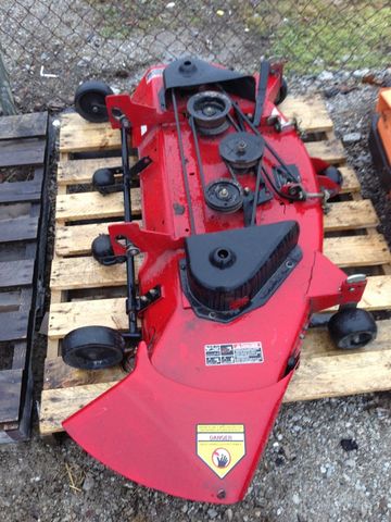

Bobie01 22 #1 Posted April 7, 2014 Hi!!! In Luxemburg City there an Toro dealer who has 3-4 Nos decks newer style 48 SD. I have to ask for the model nr. The imploye thinks that it will cost more than 500 euro. But he has to ask the boss. But What is it worth??? does ist fit to my Raider10 an my c-165 both whit attach a matic?? I can't really what is was but it has look like an attach a matic system. The belt guards are out of plastik, I have never see one like this. Share this post Link to post Share on other sites

bmsgaffer 2,071 #4 Posted April 7, 2014 Are the belt guards a black plastic? Those decks as far as I know are from an "xi" tractor (518xi,520xi,522xi ect) which is the last "wheel horse" tractor made (99-06) and will NOT fit the older attachmatic (mid 70's to late 90's) system. I do not know if these XI's were sent overseas or not, so I could be wrong. Share this post Link to post Share on other sites
bmsgaffer 2,071 #5 Posted April 7, 2014 Do they look like this: Those are the decks for the '5xi' series of tractors that will not fit attachmatic. Share this post Link to post Share on other sites
Bobie01 22 #6 Posted April 7, 2014 yes it look exactly like this... Share this post Link to post Share on other sites
bmsgaffer 2,071 #7 Posted April 7, 2014 It would not fit the Attach-matic tractors without significant modifications. It may not even fit at all, the xi's had a longer wheel base so it might not fit between the wheels correctly. Share this post Link to post Share on other sites
Bobie01 22 #8 Posted April 7, 2014 Oh WE just open 1 box maybeen there were some ohters in the other box. Maybe someone hass a list whit parts numbers so i dont have t open the boxen to look wat is in. on the sticker was a long number whit 77.... an 48" SD is that a part number??? Share this post Link to post Share on other sites
Don1977 606 #9 Posted April 7, 2014 That base runs a single belt. The older decks have two belts one on the deck and one on the PTO to the deck. I think that may be a deck for a lawn tractor with a vertical engine. Share this post Link to post Share on other sites
bmsgaffer 2,071 #10 Posted April 8, 2014 That base runs a single belt. The older decks have two belts one on the deck and one on the PTO to the deck. I think that may be a deck for a lawn tractor with a vertical engine. Was taken from an auction site selling it for an xi Looks just like my brother in law's xi. Share this post Link to post Share on other sites
