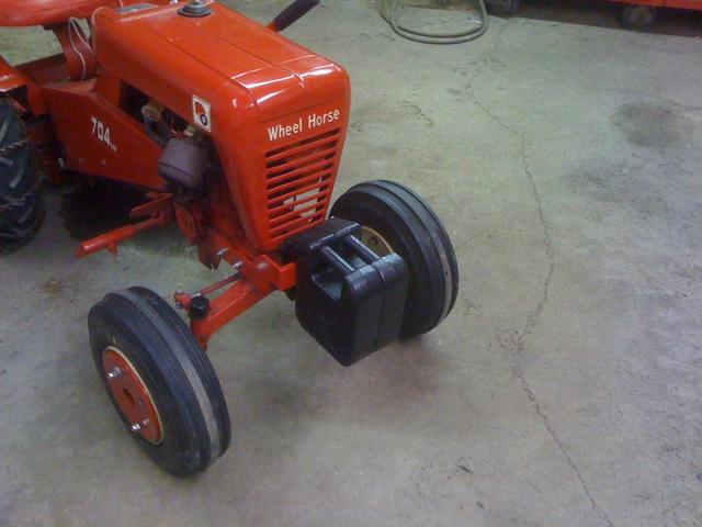

squonk 48,322 #11 Posted April 7, 2014 Suitcase weights on the front! Share this post Link to post Share on other sites

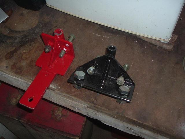

bigfkd22 11 #17 Posted April 8, 2014 Now the bad news. The clevis hitch is very hard to find. They can be had but usually very pricey. Check ebay or try to find a slot hitch adapter then the slot hitch. Those are cheaper. Share this post Link to post Share on other sites
squonk 48,322 #18 Posted April 8, 2014 These will help keep the frt end down. Share this post Link to post Share on other sites
squonk 48,322 #19 Posted April 8, 2014 Slot hitch to clevis adapters Share this post Link to post Share on other sites
