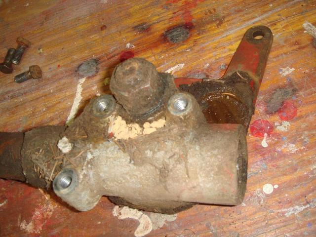

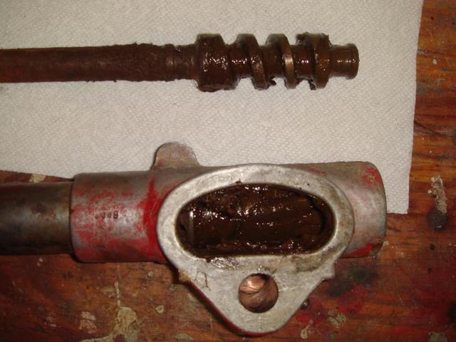

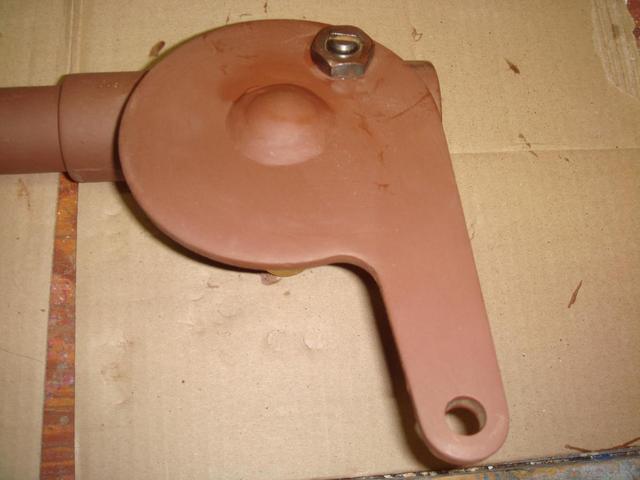

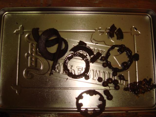

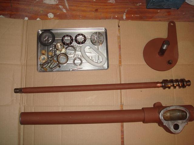

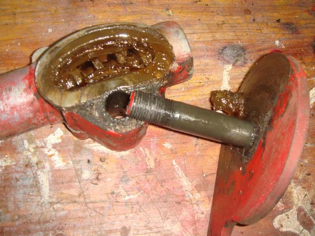

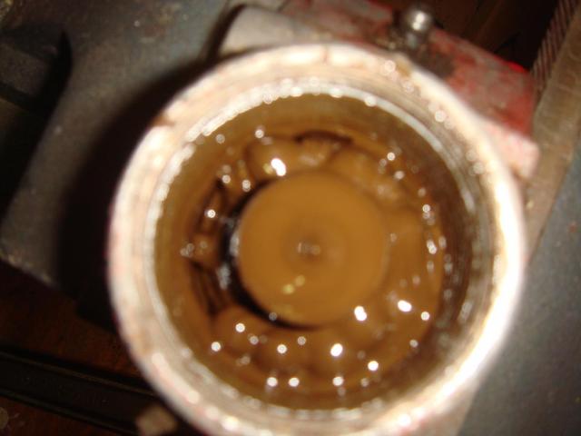

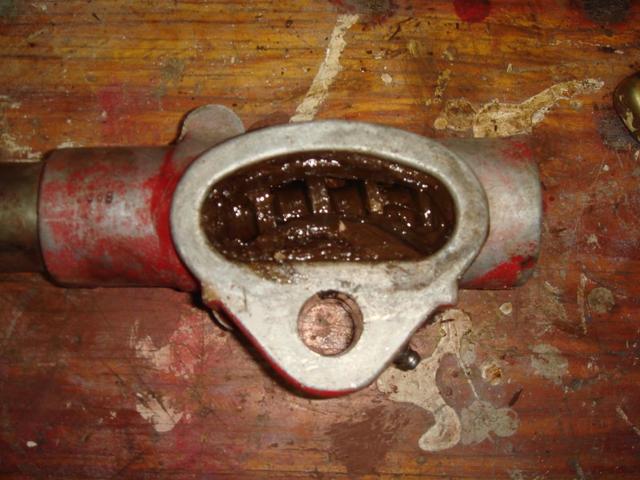

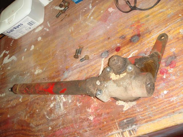

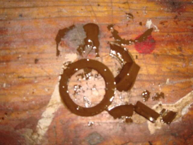

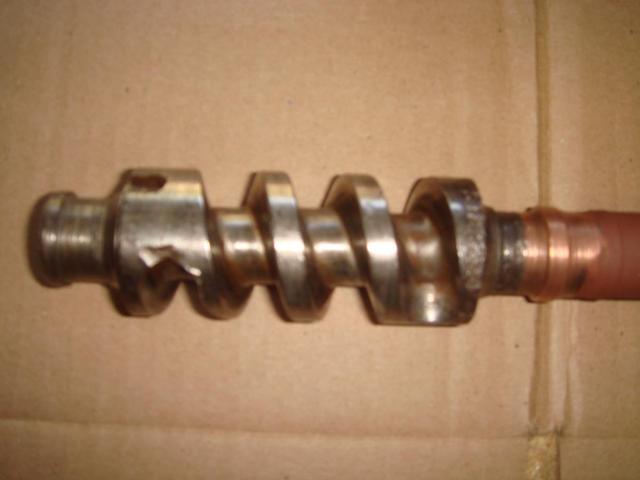

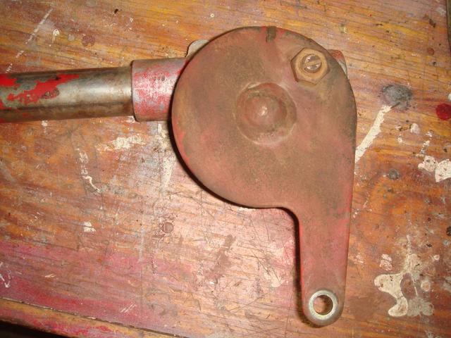

jdmitchjr@6dlam.com 5 #12 Posted April 17, 2014 So I finally had some time this evening and managed to get the steering column and steering box out. I had originally removed the bolts from the brackets but it was proving to be a puzzle I could not figure out going down or going up. But with the brackets dismounted, the assembly lowered enough and could be turned enough that I could get a wrench on the three bolts to the Ross box which enabled me to lower the column out the bottom. Found a few missing ball bearings, one cup was in pieces, and there was some stiff grease in the box. The stud was actually in pretty good shape. There were some scarring to the worm gear, perhaps from the loose cup parts, but not too bad. The shaft mid section between the worm gear and the splines had more rust and corrosion than I expected. I cleaned and wire wheeled all the parts, test fit the new parts, and painted the shaft mid section, the column, and the lever with rusty metal primer. I need to find a bearing for the top of the column and a sealed thrust bearing for the lever stud and then I should be able to complete the reassembly and then repuzzle the column and box back in. B/R John Share this post Link to post Share on other sites

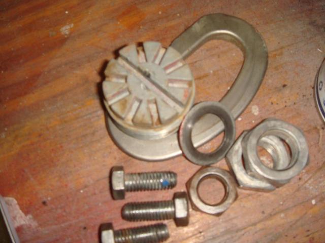

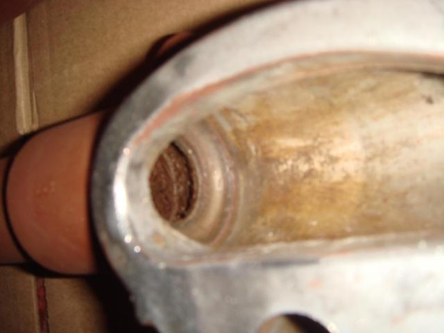

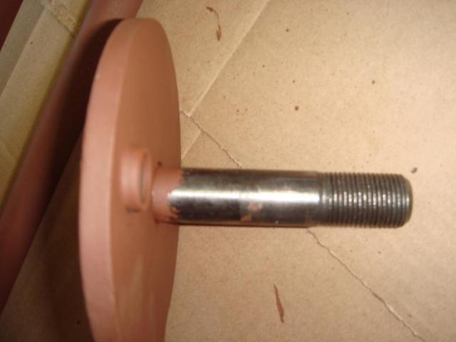

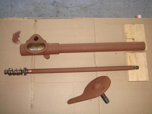

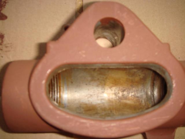

jdmitchjr@6dlam.com 5 #13 Posted April 20, 2014 Just a quick update on what I found when I cleaned the parts. All the ball bearings where there but not where they belonged. Half were smaller than the others - very odd. The stud I ordered turned out to be the wrong size. I guess that happens when trying to cross to other brand part numbers. Luckily the old stud is okay with a little dressing. The busted cup was definitely part of the slop problem. The upper bearing cup is stuck, probably rusted in place. But the bearing surface cleaned up nice and the cup is solid so it should be okay. Reassembly tomorrow night and then the fun of getting it back in. The red craftsman gt5000 did the dethatch, vac, and fertilizing duty today. Photos of the rebuild to follow. B/R John Share this post Link to post Share on other sites

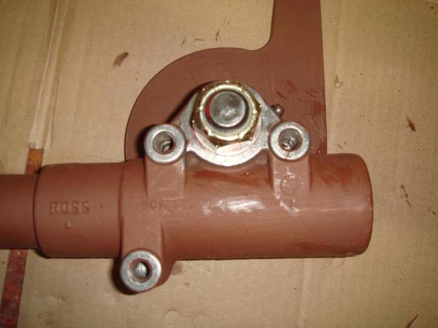

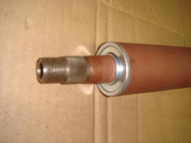

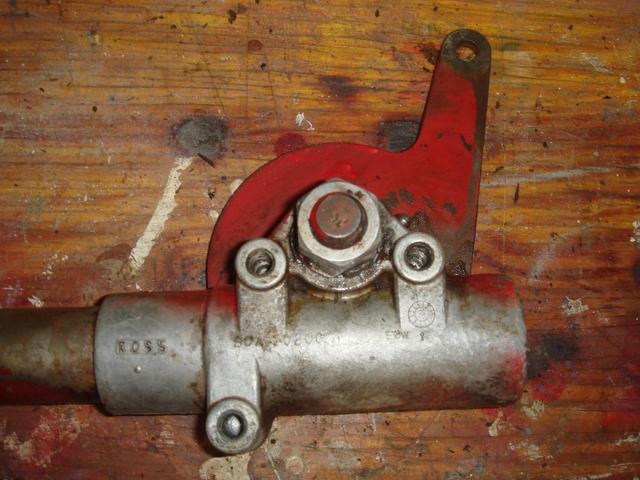

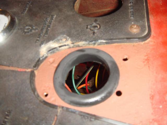

jdmitchjr@6dlam.com 5 #14 Posted September 25, 2014 Sorry to be off line for so long and for not finishing up this thread. I got interrupted by a wrecked Jeep that had to be made road worthy and then a partial engine rebuild on the replacement Jeep, in addition to the other work 'round the house and grounds. in any event, the column and steering box rebuild went pretty well. The only issues were the wrong size stud or finger noted above and I did not end up doing the thrust bearing on the pivot. Reinstallation went fairly well without any problems -- just some contortions to get to the nuts and bolts. The supply of the rubber dash grommet from a member was a great final detail. Photos of the work in progress. I did not take any of the re-installation or even the finished job. The steering is much improved but I think I was too conservative on how much to tighten the follower finger or stud into the worm gear. I am going to tighten that up. Next step is to replace the spindle thrust bearings. Thanks to all the folks who provided comments in support and especially to those who posted their own experience and photos. All were helpful. B/R John 1 Share this post Link to post Share on other sites

jdmitchjr@6dlam.com 5 #16 Posted October 20, 2015 I saw your post but am away from where I have the information on the parts. When I get home this weekend I will respond more fully.For now....The bearing at the top of the column cam from McMaster & Carr and was jb welded in place.The bearings in the box were a matching part number from another tractor company -- I got the information from another great thread on rebuilding the column.The following pin that came with the parts was not the right size so I ended up cleaning up the out of round pin on the grinder being careful not to let it get too hot and soften the part.The dash grommet came from a very nice Red Square member who had at least one extra at the right time for me.Otherwise the big problem is getting the assembly out of the tractor to work on. I will see if I can find the other link and get that information to you. Otherwise look for another post on Sunday.Regards Share this post Link to post Share on other sites
jdmitchjr@6dlam.com 5 #17 Posted October 29, 2015 (edited) Attached is the information I found on the site to get the parts.Note that the following pin was the wrong size so I reground the original. Also, I found that the bearings on the wheel spindles were shot and cleaning the spindles, removing the remainder of the disintegrated bearings, re-greasing, and installing new bearings (from McMaster & Carr) made steering much easier and that probably eases the work for the steering box. Hope this helps. steering parts.pdf note that there is an image AND a pdf -- you should look at both for parts information. Edited October 29, 2015 by jdmitchjr@verizon.net 1 Share this post Link to post Share on other sites
