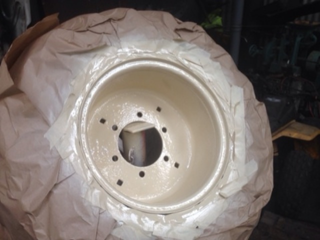

diggerjames 64 #2 Posted April 6, 2014 I fitted new tyres to my d200 and should of painted them first but I didn't want to damage the paint so I masked them up like so hope this helps James Share this post Link to post Share on other sites
rustykan 140 #3 Posted April 6, 2014 I fitted new tyres to my d200 and should of painted them first but I didn't want to damage the paint so I masked them up like so hope this helps James That's exactly what I was thinking. How do you like how they turned out? Share this post Link to post Share on other sites
kudzu3 323 #4 Posted April 6, 2014 Paint the wheels, have the tires mounted, leaving the air out. By leaving out air, masking will be much easier for touch up. When finished add air. 2 Share this post Link to post Share on other sites

diggerjames 64 #6 Posted April 6, 2014 That's exactly want I did like Kudzo3 let the air out sand mask under the beading ! Share this post Link to post Share on other sites
